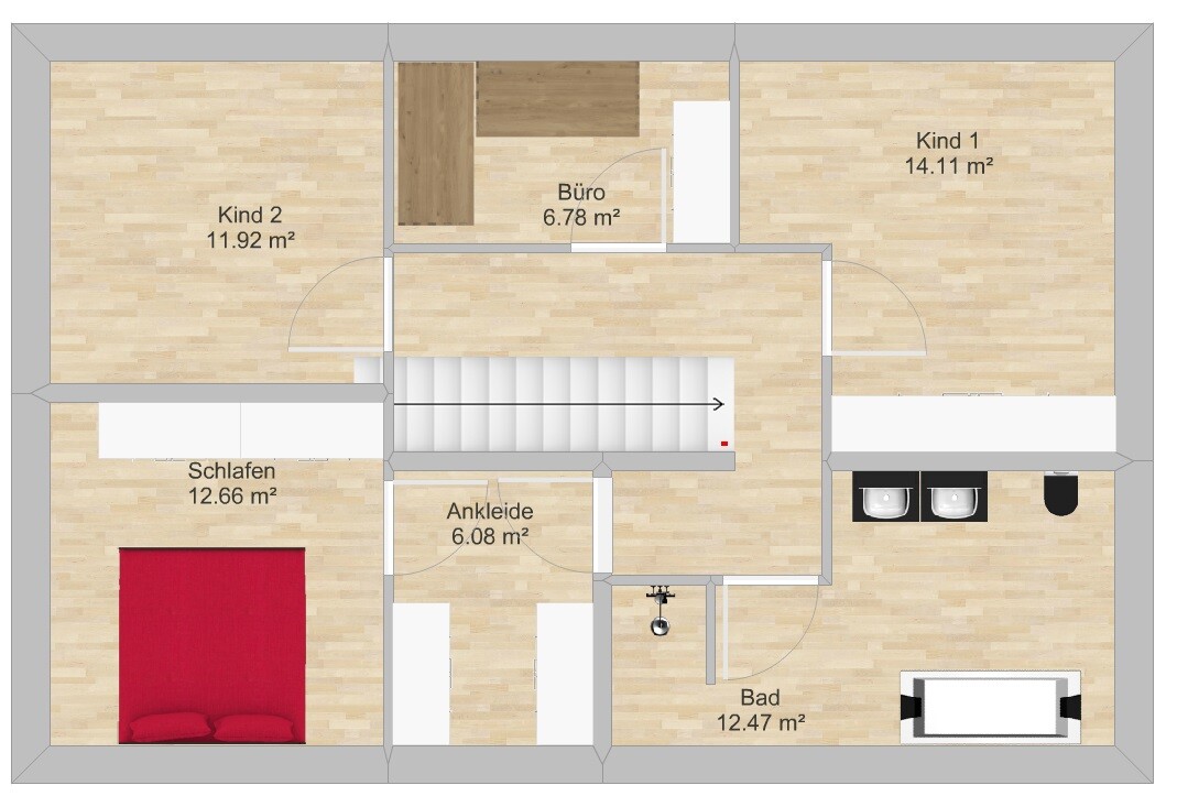

We are fortunate to have acquired a plot in a new development area. However, the building envelope seems to be designed more for a duplex than for a detached single-family home. Since our neighbors and we would prefer a detached single-family house, we are looking for solutions and improvements to the architectâs floor plan. As our family owns a construction company and we are receiving a âdiscountâ because of this, we are somewhat tied to the architect, even though the design doesnât always maximize the potential.
Therefore, I would like to ask you to take a look at the floor plan. I have also attached another draft of my own. I am open to suggestions and opinions.

Bedroom: why two windows? Remove the window on the left side of the plan and then the bed will fit.

EDIT: Isnât 2.9m (9.5 feet) a bit tight for a bed and nightstands? The longer window is more like a "basement window" with a sill height of 1.75m (5 feet 9 inches); we were actually planning to place the bed below it.

- Is the utility room also intended for housing technical equipment? 6.xx m² (about 65 sq ft) for both seems a bit small to me.
- I would reconsider the layout of the upper floor; as it is, it just doesnât work.
1. No space for a bed.
2. The office is just big enough for a small workspace. Apparently, a wardrobe is planned behind the door, then an L-shaped desk on the left and top sides of the room. Adding a shelf at the bottom side isnât really possible because 1.80 m (5 ft 11 in) is already too narrow for that.
3. I can accept Child 1âs room. The niche can be used well for a bed or desk. But Child 2âs room is completely inadequate. Even if you argue that your family planning is complete, I think 12 m² (about 129 sq ft) is a total waste. It simply cannot be furnished properly at all.
4. The distance from the bed to the bathroom is probably the longest possible within the house.
The root of the problem, in my opinion, is the position of the staircase. It works because of the protrusion on the ground floor, but it makes the upper floor almost completely unusable.
Attached is a suggestion. To be clear, I would reconsider the entire floor plan because I donât find the stair location suitable.
Downside: You can only fit two 1.5 m (5 ft) wardrobes in the walk-in closet. On the other hand, you could move the wall in the master bedroom at the top side towards Child 2âs room, so that a 3 m (10 ft) wardrobe fits, as I have indicated. However, that also partly defeats the purpose of having a walk-in closet if you end up with wardrobes back in the bedroom again.

- The walk-in closet is not a confined space, which is especially convenient if sleepers have different bedtimes.
- The bed area is sufficiently spacious.
- Child 2âs room becomes more usable.
As mentioned, this is just to offer some ideas.
