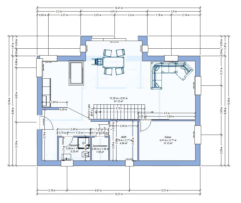

We are fortunate to have acquired a plot in a new development area. However, the building envelope seems to be designed more for a duplex than for a detached single-family home. Since our neighbors and we would prefer a detached single-family house, we are looking for solutions and improvements to the architect’s floor plan. As our family owns a construction company and we are receiving a “discount” because of this, we are somewhat tied to the architect, even though the design doesn’t always maximize the potential.
Therefore, I would like to ask you to take a look at the floor plan. I have also attached another draft of my own. I am open to suggestions and opinions.

What do you especially like?
Orientation of living rooms towards south/southwest, space utilized under the stairs
What do you not like?
Side entrance. Because the entrance is on the side and the garage is set back, parking will be awkward and there is no room to place a doormat in front of the door…
Only 3.5m (11.5 ft) width for the living room, 4m (13 ft) would be preferable. However, I don’t like the hallway/staircase in my own design either because the stairs feel cramped and the hallway is quite long.

Hmm, does the staircase fit? It looks to be only about 300 cm (10 feet) long on the ground floor. I’m linking again:
It should be around 360 cm (12 feet).

Painkiller schrieb:
Hello again,
I found a floor plan online that I quite like.
Unfortunately, the entrance is on the long side, but it does have a straight staircase, one extra room, and a spacious hallway.
Please let me know what you find problematic about it and if you have any ideas on how to place the entrance on the short side instead.
Best regardsI don't see the problem: just move the two rooms on the left side according to the plan, keep the kitchen wall, and adjust everything else... Then you'll have your entrance on the short side.
