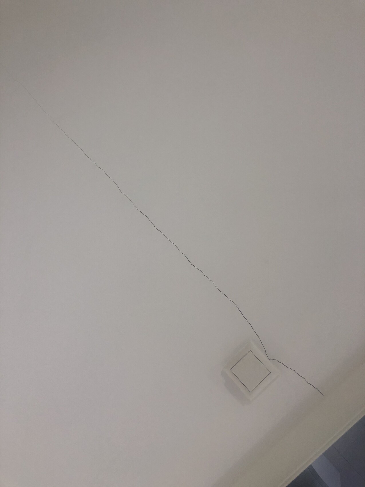

On the upper floor, there are noticeably many cracks (on the ground floor, we did not see any cracks). Some of them run straight through the wall.

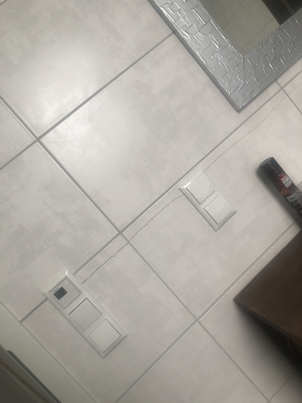

I have attached two pictures. The crack is on a 17.5cm (7 inch) thick masonry wall. On the back side of this wall is the bathroom. Apparently, the crack caused 3 bathroom tiles to crack.
Are these cracks cause for concern?
The seller said that such cracks are normal in new buildings. He himself was told this when he tried to report it as a defect to the construction company about 2-3 years ago.

HilfeHilfe12 May 2020 10:57Yes, settlement cracks—masonry does shift over time. Although I find that quite severe when it comes to tiles.
Have you considered getting an expert assessment?
T_im_Norden12 May 2020 11:26Without assessment by an expert engineer/structural engineer, I would consider this too risky.
nordanney12 May 2020 11:32aldi1985 schrieb:
Are these cracks a cause for concern?Usually not, as they are typical settlement cracks.aldi1985 schrieb:
The seller said that such cracks are normal in new buildings.Yes.I have a rented apartment where, even 55 years after completion, cracks appeared on a wall after some work was done outside near the sewer.
Annoying, but more of a "cosmetic defect."
