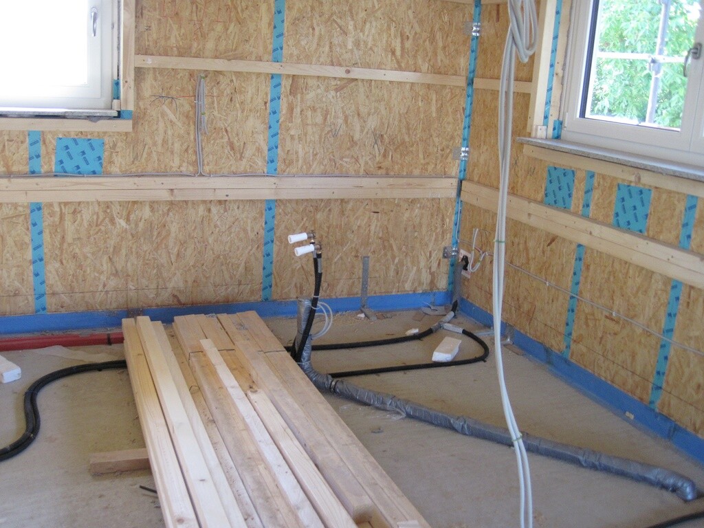

wrobel schrieb:
Hello again
At the installation level within the stud wall, every cable, water pipe, and electrical outlet penetrates the airtightness layer.
I am mostly building my house myself. I contracted the shell construction on the concrete slab to a local carpentry company.
OlliNote for non-experts:
As far as I know, the airtightness against outdoor air is ensured outside of the insulation layer, for example, by rigid panels. The vapor retarder is actually supposed to slow down diffusion to prevent condensation.

Irgendwoabaier20 Nov 2015 20:09BastianB schrieb:
Attention, non-expert knowledge:
[..]Then the airtight layer on the inside of the main insulation would not need to be sealed so carefully. Unfortunately, that is not the case – see the attached picture (our kitchen – it looked like this 16 months ago). After that, some wood wool boards were added on the inside, followed by drywall. On the other side of the OSB board: cellulose insulation / timber frame, then 60mm (2.4 inches) wood fiber boards (certainly not airtight), then plaster...
