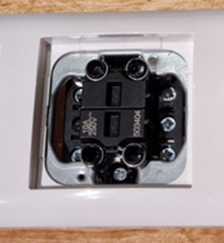

hausbauer620 Jan 2026 22:01The existing installation uses Busch and Jäger Balance SI. Blinds are to be retrofitted, using as few flush-mounted boxes as possible. I want a traditional installation without any control system. Busch and Jäger do not offer a 4-gang rocker switch in their product line, so an alternative needs to be found. I searched for switch series that can be combined with Balance SI or are very similar to it.
Comparison:
Busch and Jäger Balance SI alpine white
Berker Modul 2 / S.1 polar white
Gira System 55 pure white glossy

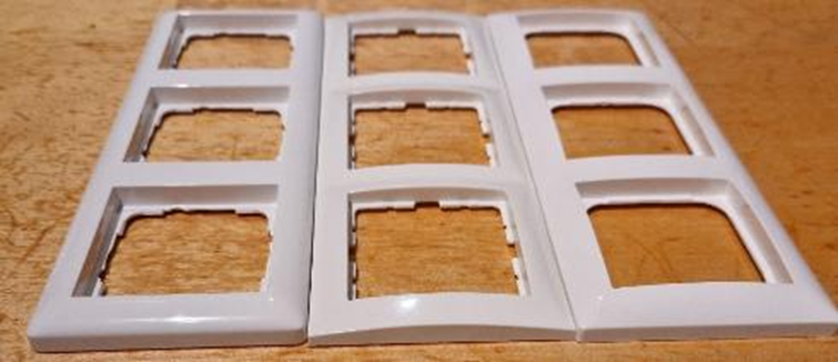

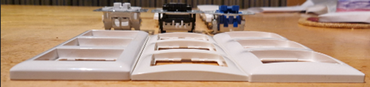

Comparison of multiple-gang frames

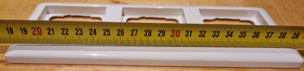

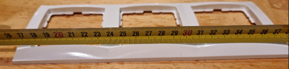

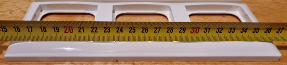

The Berker S.1 frame is very flat with a thickness of approx. 9mm (0.35 inches). The rounding between the individual compartments in the multiple-gang frames is quite pronounced.
The Balance SI frame is 12mm (0.47 inches) thick and has only slight rounding between the individual compartments.
The System 55 frame is 11mm (0.43 inches) thick and has a straight line across all compartments in the multiple-gang frame.
The recesses in the frames and flush-mounted inserts are manufacturer-specific, although the external dimensions of the frames, switches, and flush-mounted inserts are the same.

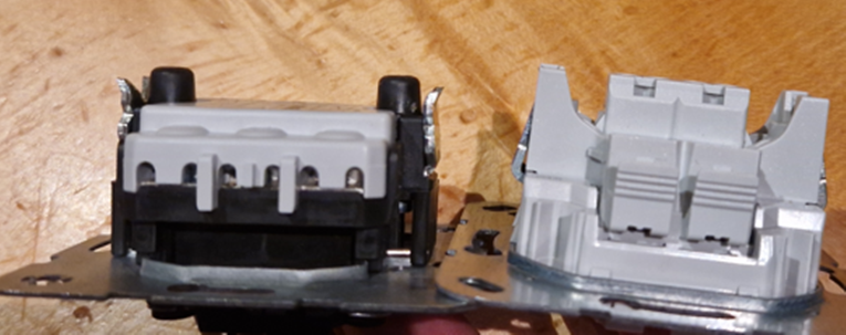

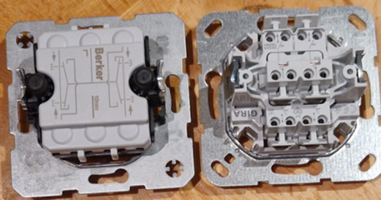

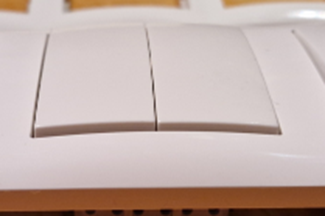

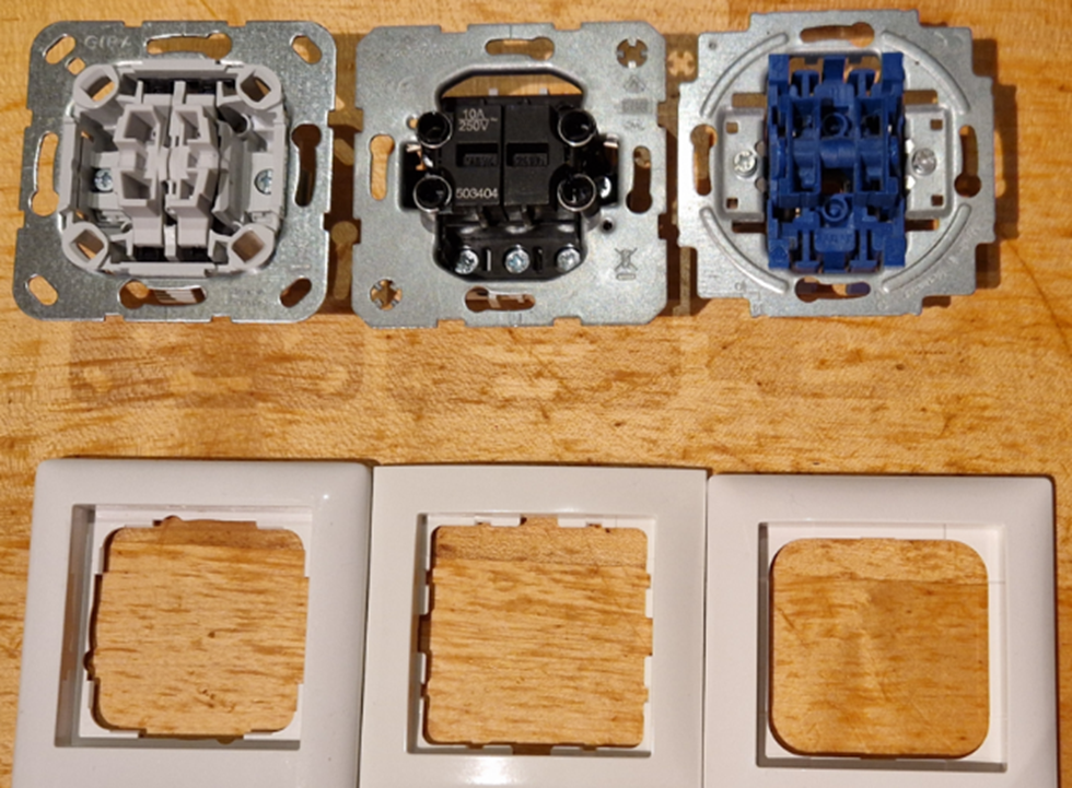

The plastic of the flush-mounted insert from System 55 fits well with the Busch and Jäger frame and has only minor play. The switch cover rests only on the corners but holds the frame securely. From the outside, the switch cover does not look harmonious as it is completely flat and therefore protrudes more at the corners. The actuation point is very good, and the clicking sound when pressing is pleasant.
The Gira switch insert (shown on the right in the pictures) requires a slightly deeper flush-mounted box because the left two rockers and the right two rockers can be supplied separately, and the wires are connected from the back, not from the side.

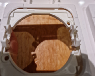

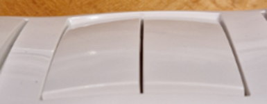

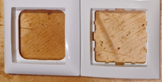

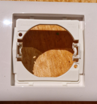

The Berker S.1 inserts do not fit as well here. The flush-mounted insert is flat, similar to Busch and Jäger, and the centering is done via the switch cover. The cover has two small tabs at the top and bottom, which center it within the Busch and Jäger frame. Since the frame lacks recesses like the original S.1 frame, there is a gap between the metal of the flush-mounted insert and the switch cover. The two hooks on the left and right do not fully snap into the flush-mounted insert, but it still holds. The switch cover matches the frame curves very well. The clicking sound is louder and “rougher” than Gira’s, and the actuation force is slightly higher.
On the left, the S.1 switch cover in the Balance SI frame: the tabs center the frame, but the cover remains with some gap. In the center and right images, the original S.1 frame with recesses for the tabs and exact fit is shown; the cover and frame are flush at the back here.
The Busch and Jäger frame could be milled to add these recesses, but then the switch cover would slide further into the frame, which is thicker than the original frame. When pressing the switch, the frame would then protrude.
Decision
I will use Berker S.1. It matches very well visually with the Balance SI system, and it is hardly noticeable that a different system has been integrated.
