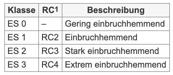

The entrance doors have a profile cylinder lock and burglar-resistant hardware ES1 according to DIN 18257, plus a security door plate with core pull protection and lock cylinder on the outside covered with hardened metal. I don’t know which RC class that corresponds to.

Edit: I just noticed that ES1 corresponds to RC2. See the table attached.
ES-Klassen ES0–ES3 mit RC1–RC4, von gering bis extrem einbruchhemmend beschrieben

ES 1 only refers to the security fitting, not the entire system (e.g., the door).
Your windows and patio doors are the weakest points. RC1N is misleading—it's not even RC1.
