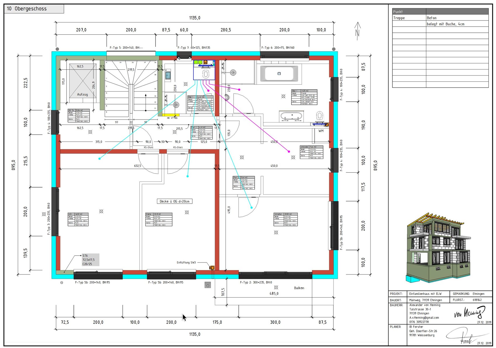

maybe this topic has already been discussed. As far as I know, the reduction is too high.
But our structural engineer thinks it is negligible. Attached is an excerpt from the plan.
Perhaps there are already experiences on this topic here.

In the design and installation manuals of major manufacturers, you can find information about the impact on structural stability.

General contractors usually use 22 here, my structural engineer wanted 24. Whether 20 would be enough should be decided by the structural engineer.
Any opinions?
