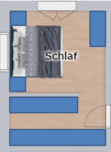

Hmm... the storage room upstairs seems unnecessary if the utility room is located there.
I don’t like the bedroom layout. Or rather, it depends on what the walk-in closet will be used for.
And how is the bed supposed to be positioned? In front of a window?
I think 3.60 x 3.70 meters (12 x 12 feet) is probably too small for a living room for up to 5 people.
The storage room somehow remained; it could potentially be used as a second walk-in closet, but it might be too narrow for that.
The bedroom arrangement was planned like this, with a sort of clerestory window above the bed and a floor-to-ceiling window facing north. Does that make sense? The bedroom could also be made slightly larger at the expense of the office.
