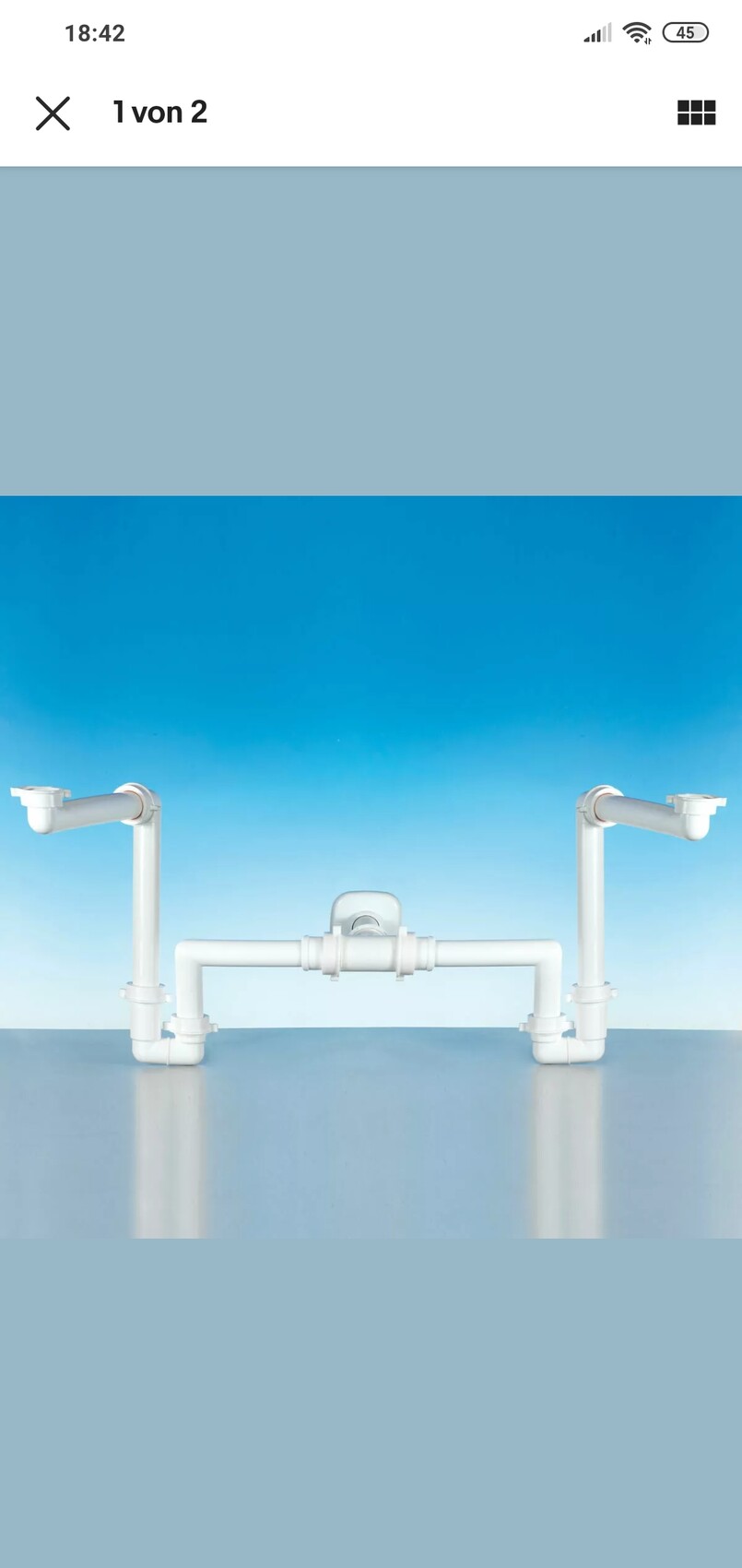

To clarify again: We have supply and drain pipes installed inside the closed wall.
From the supply line, I need to branch off two lines to two faucets. So far, I haven’t seen any issues with this. We have already done this in the kitchen because we have a side-by-side refrigerator with a direct water connection there.
Now I’m still looking for a solution for the drain.
I have been searching for exactly what @tomtom79 described.
I couldn’t find anything like that at our local hardware store.
So I guess I will have to go to one of the larger retailers.
I can already see this coming.
