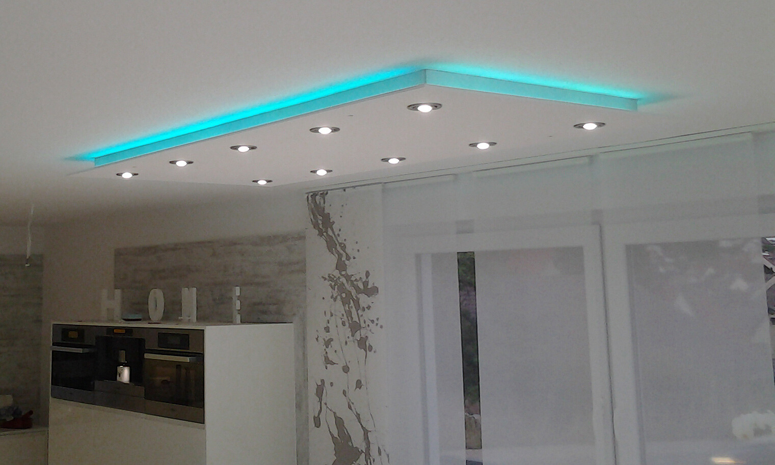

It is not always necessary to lower the entire ceiling; partial ceiling features can look very attractive. For example, creating a large, color-contrasting box (possibly several square meters) around the existing ceiling outlet, fitted with spotlights. This is sometimes called a "ceiling sail." Alternatively, narrow light strips with LED strips along the edges, combined with some spotlights, can be used.
Both options can be done very well and reduce the loss of room height compared to a fully lowered ceiling.
