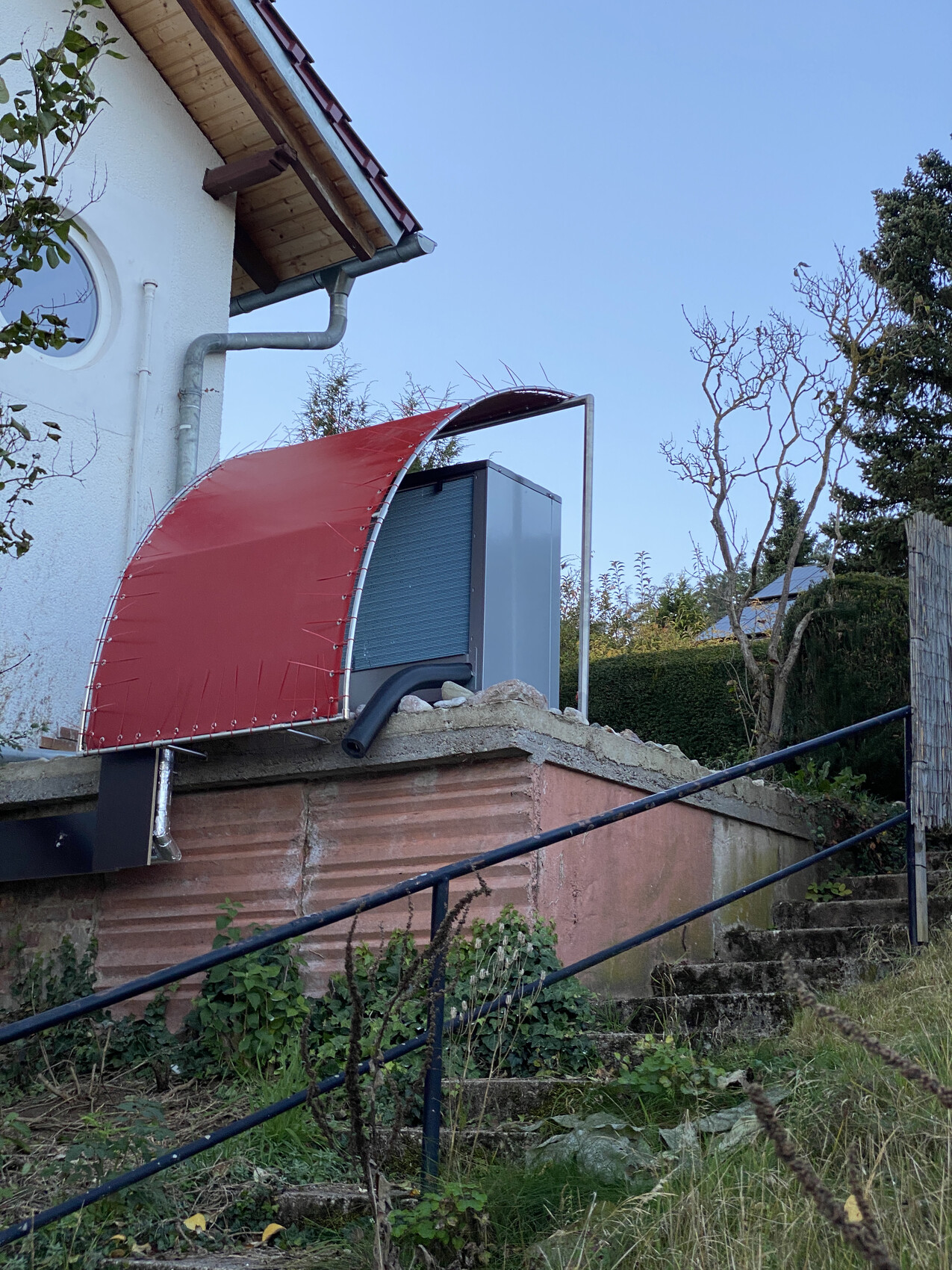

ateliersiegel schrieb:
Today, the installer for our heat pump came by because it had stopped producing heat after heavy rattling from the outdoor unit with the fan. Now everything is working as it should. One function—the defrost control—was newly adjusted.
The technicians’ assessment was that the fan had iced up, and this setting is meant to prevent that.
This adjustment consumes a bit more electricity, and without it, operation would be more efficient.
The wind must not blow too strongly into these units.
They are usually placed against a house wall. That would have been next to our front door, which we didn’t want.
That’s why I made this cover, although it’s now believed that too much wind still comes in from the side.
I was especially proud of the design detail that allows the entire cover to be easily folded away if maintenance is needed (although that is supposedly only necessary from the front, which is open anyway).
Now I’m thinking about a solution for the side...
