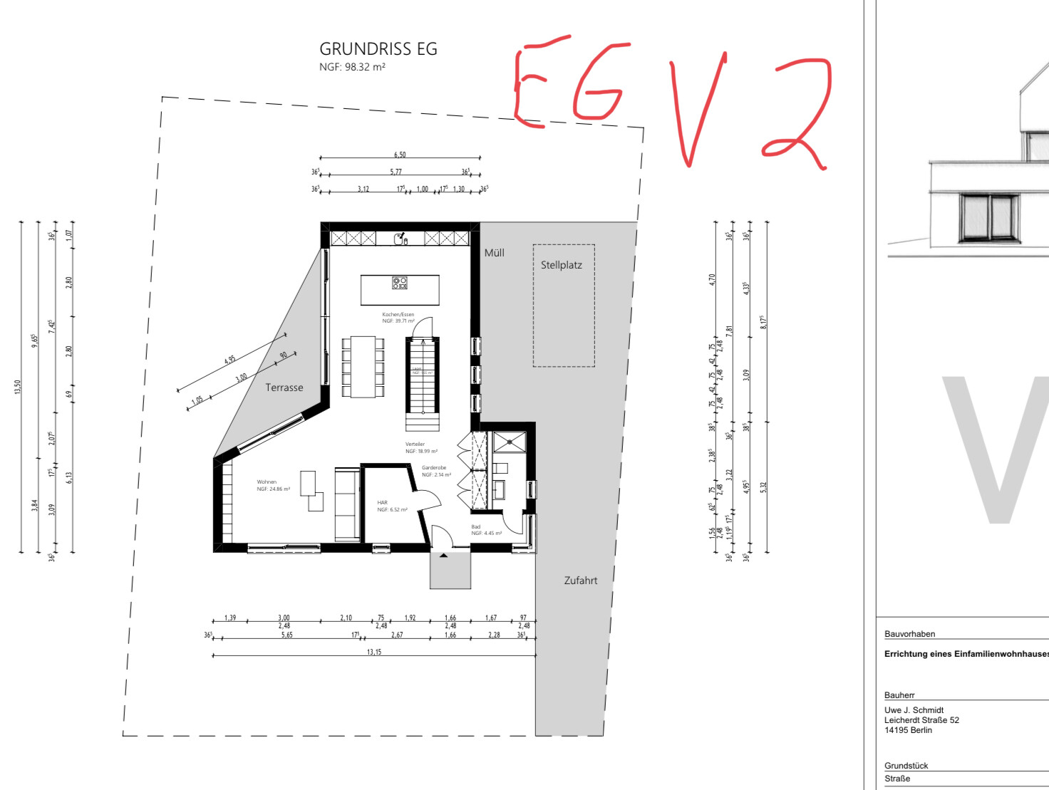

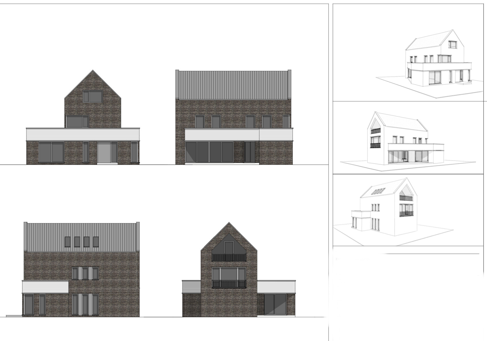

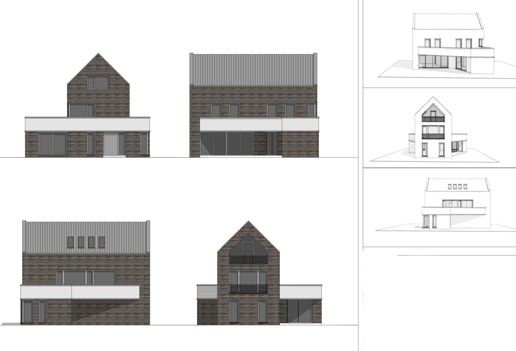

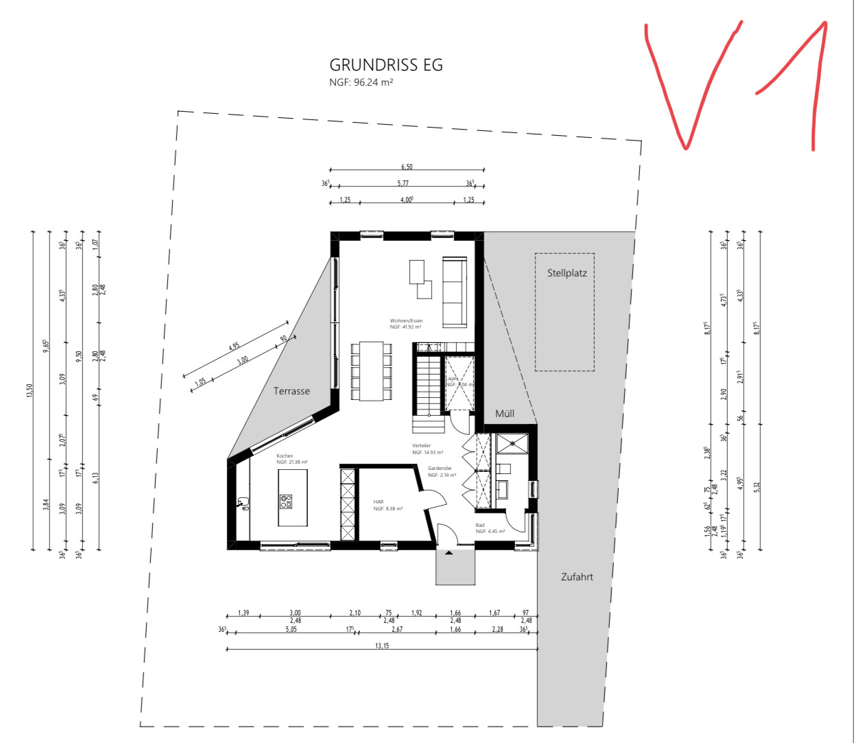

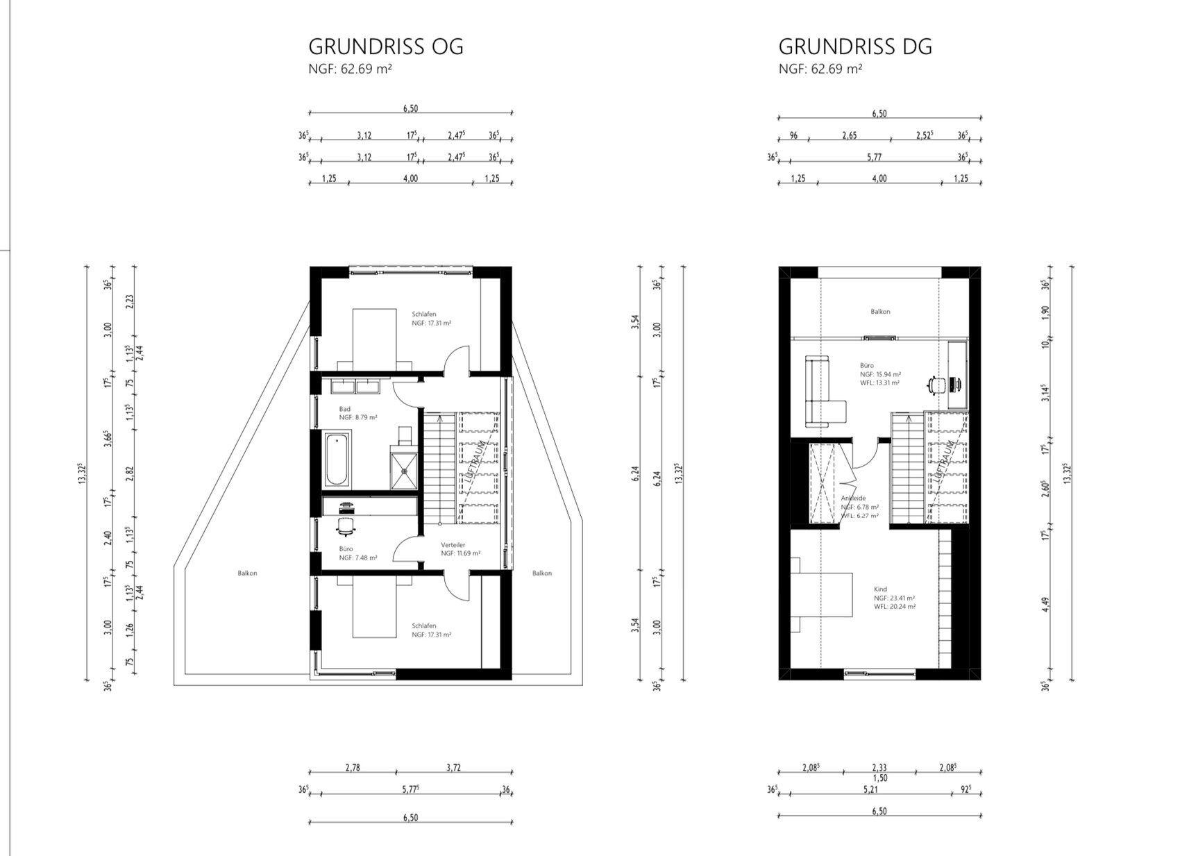

So, the architectural work has progressed... I’m still not completely satisfied with it (NO, I did not initiate the slant on the left side of the ground floor, and I don’t think it’s ideal here either), but maybe you’ll find the basic idea of a T or L shape fitting, especially the concept of “two” building volumes (horizontally wide facing the street, with a vertical barn placed on top).
There are two ground floor versions: one with the living room in the left wing and kitchen plus dining in the “barn,” and the other switched around. Any feedback from anyone is welcome.
Stair placement?
Bathroom on the second floor??
Version 1 or Version 2 for the ground floor? Or Version 3?
Stair placement?

the concept of "two" building volumes (horizontally wide facing the street, vertical barn built on top In a laudation for the winner of the Posemuckel Architecture Award, one might call that a concept, but...
UJS-Nord schrieb:
Any criticism from anyone is welcome. Al Borland, his mother, and I don’t think so, Tim 🙂
