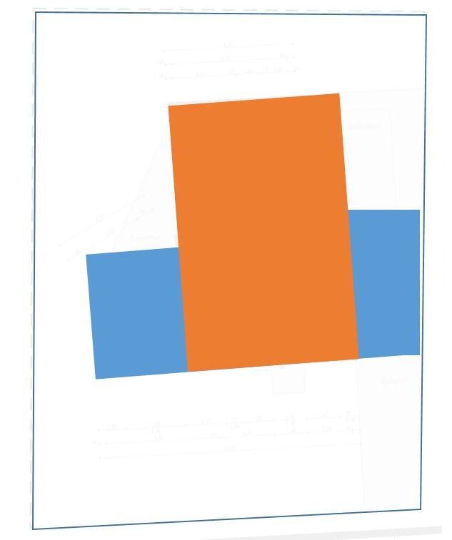

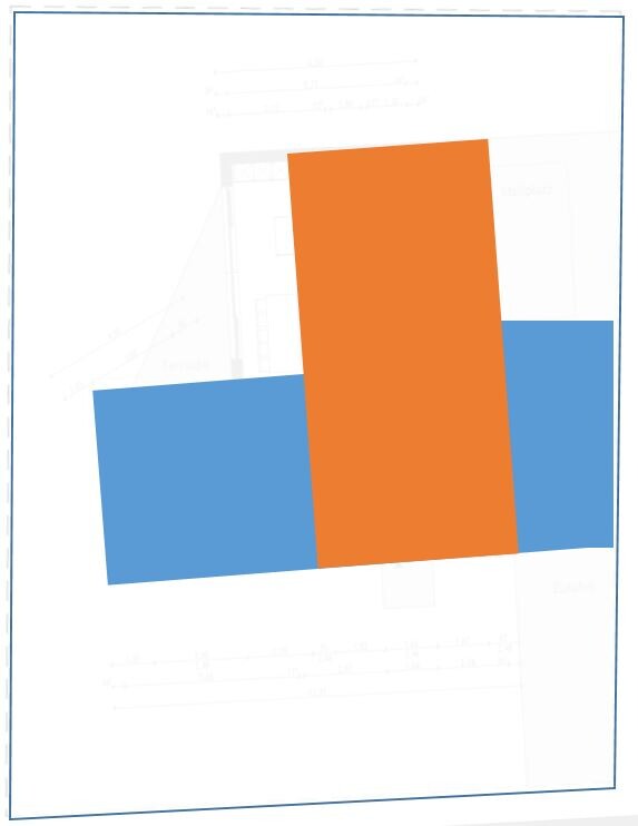

See my suggestions.
Yes, that is conceivable for us, but on the other hand, the south-facing garden will become correspondingly narrower, and 6m (20 feet) is not very spacious for two cars. One might have to park on the street...
No, only marginally. At the very top, you also have 6 m (20 feet).
Yes, no added value.
I agree.
That would work easily if we decide to have a basement (which would eliminate the utility room). We are currently commissioning a soil surveyor...
That should also be possible with some re-planning.

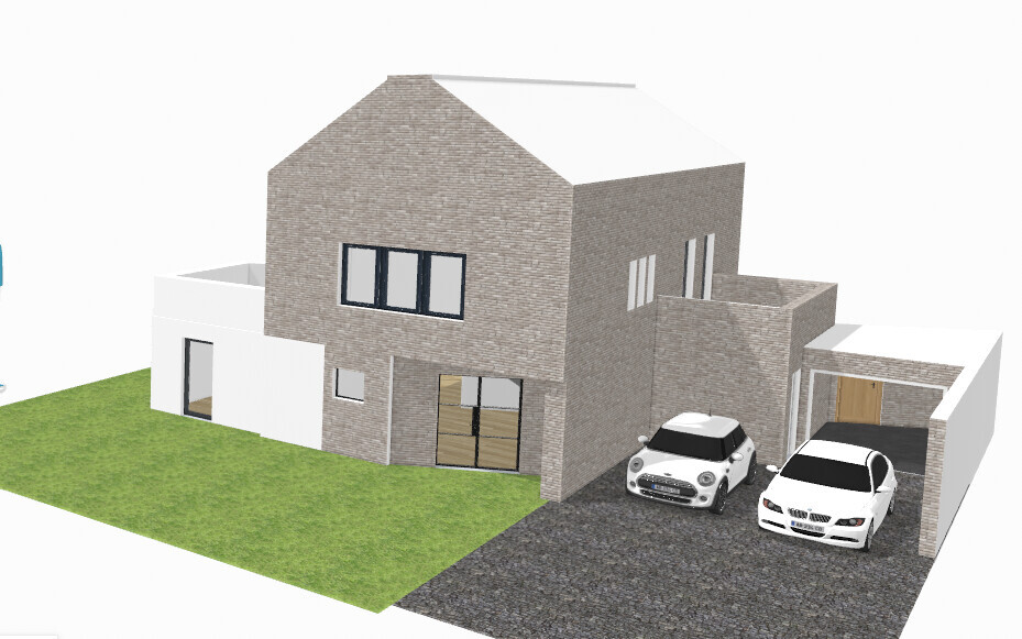

Question:
What do you think about the facade...?

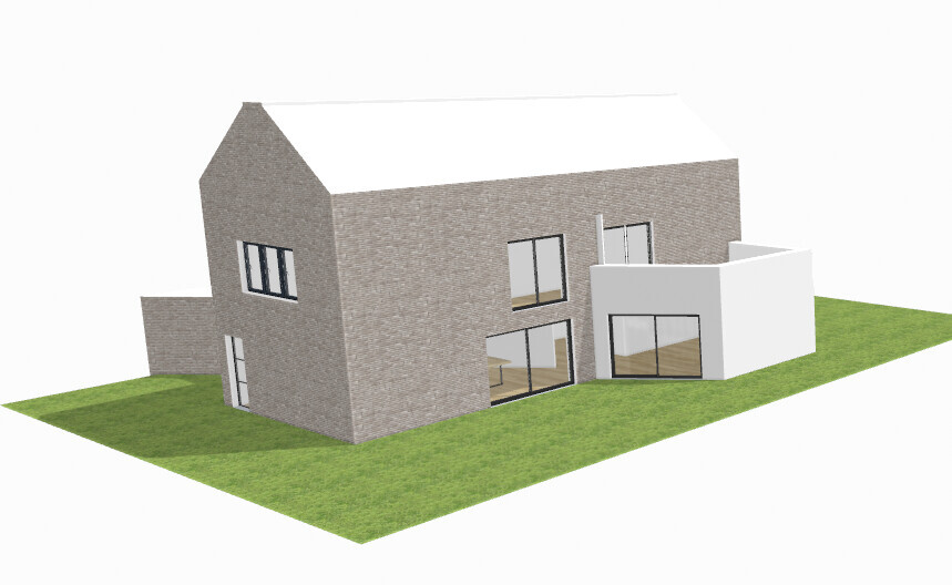

If you like it, why not. Brick facing is quite expensive. If you have any questions, feel free to ask. First comes the house on the plot, then the floor plans.

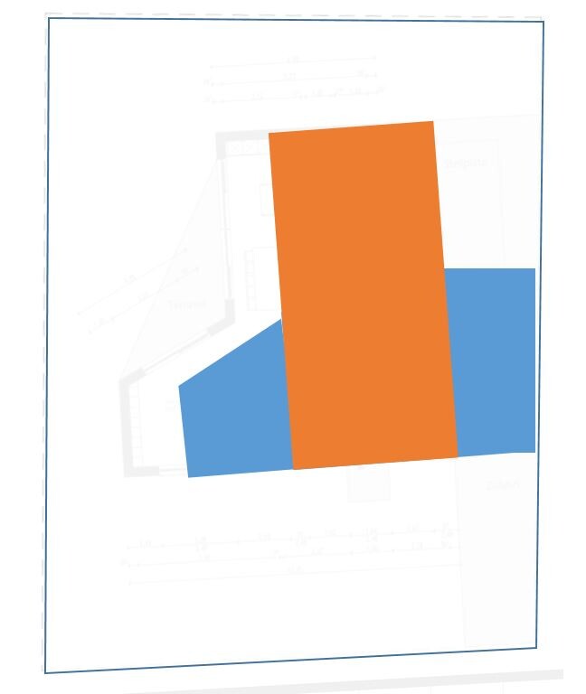

It also works with the sloped wall.
[ATTACH alt="Grundstueck44.JPG"]61566[/ATTACH]Personally, I think that if you use a sloped wall, the angles should either be kept consistent, repeated, or limited to just 90 degrees.I experimented a bit until I reached the attic: it’s true that there are quite a few limitations when it comes to stair placement. I gave the main house a width of 7.50 meters (25 feet), then took a knee wall height of 130 cm (51 inches), and with my stair setup (straight but adapted from the sloped wall, so it is effectively "shorter" in width), it doesn’t fit at the top.

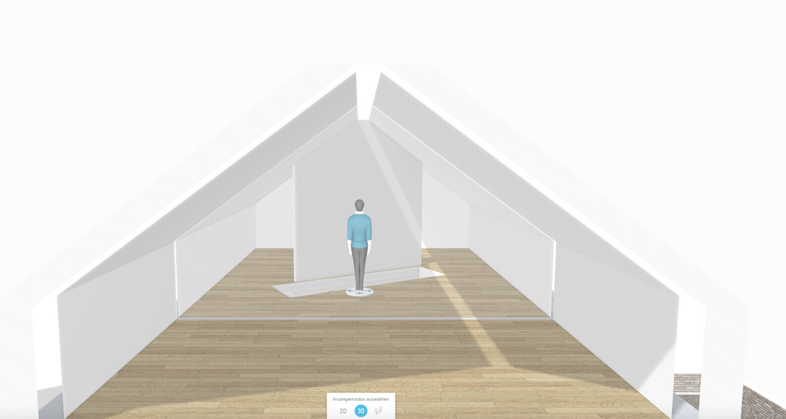

Actually, the stair layout should be like the one the designer drew if you prefer a straight stair.
And when I imagine how I could place it, I also think of an open space above… which the plan includes. So although the design isn’t perfect, the reasoning behind it is clear to me at least 😀
Attached are three screenshots of the unfinished house…
hanghaus200020 May 2021 15:38@ypg Move the existing staircase 20cm (8 inches) to the right, then place the pantry and toilet between the wall and the staircase. This way, you can still easily exit at the top within the 2m (6 ft 7 in) line. The 20cm (8 inches) will also benefit the dining table. Can you try shifting the upper floor to the building boundary? Would this then create a storage room next to the carport?
Otherwise, it’s a good approach. I also don’t like the fully brick-clad house.
