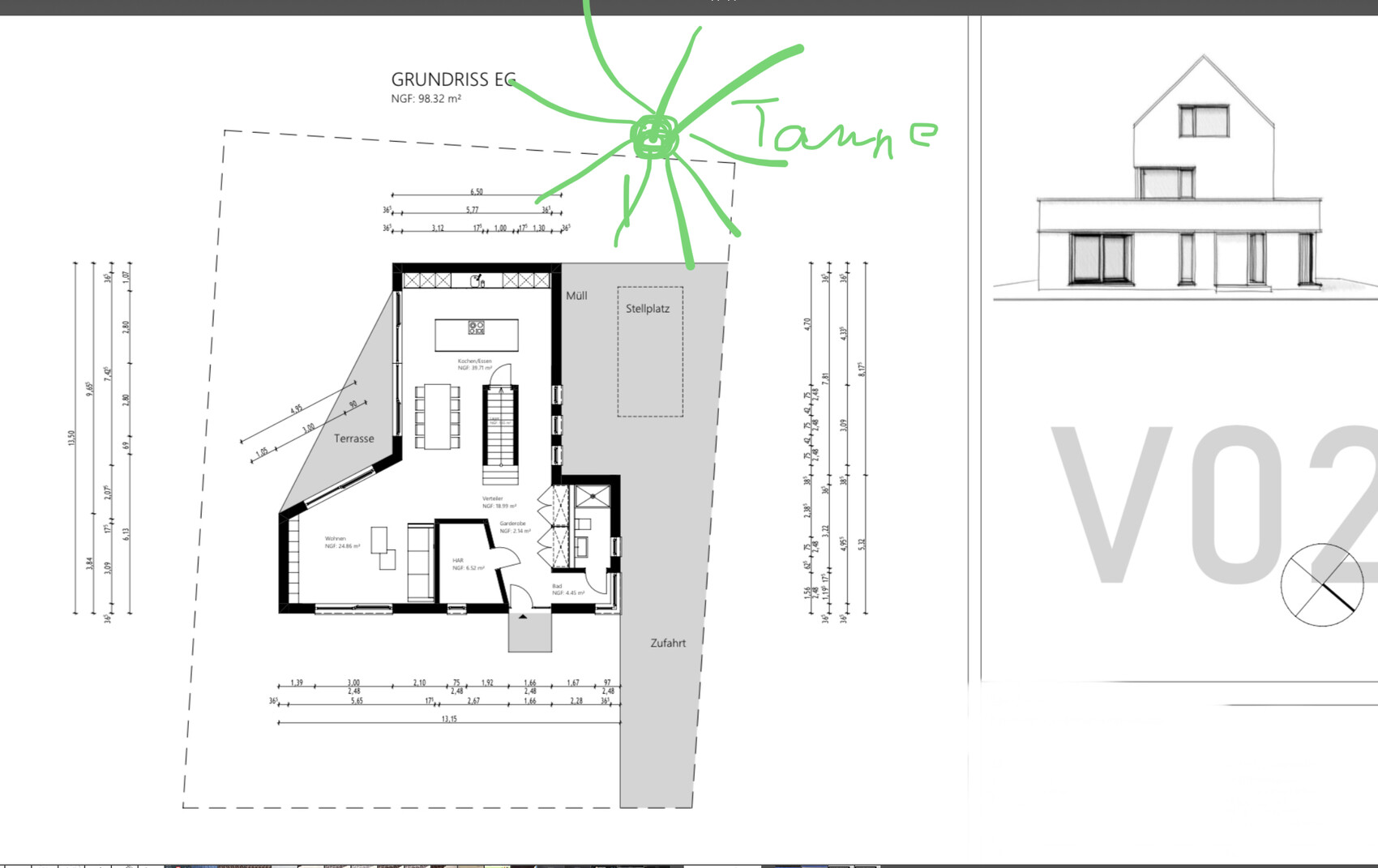

hanghaus200020 May 2021 11:34UJS-Nord schrieb:
Sorry, attached again with a north arrow.
Why is the parking space so far in the back? Without any real reason, and not practical, except that there is more width available there than directly next to the house. The only planning requirement is no parking space IN FRONT of the house within the 7.5m (25 feet) zone. Thanks. Is there no requirement for 2 parking spaces where you are?
UJS-Nord schrieb:
With layout V1, the kitchen on the left means you have to walk around the utility room block from the entrance.You could swap the kitchen and the utility room. Then, you could separate the utility room at a right angle to the sloping wall. The kitchen could be placed where the dining area is now... could, would, chain of thoughts.UJS-Nord schrieb:
But at the cost of having no real dining room, only a corridor-like space that doesn’t work, just a passage area. For me, a dining room like that is a dealbreaker.Since you already mentioned dining room and not dining area: because you have the route on the right side to the living room, I wouldn’t be too worried about 3.10 meters (10 ft 2 in)...UJS-Nord schrieb:
So why is the staircase located there? Why not further forward on the right or at least along the right wall?The planner’s intention was probably that you reach the upper floor with the staircase position. I wonder why you both haven’t discussed this together. She should be explaining the advantages and reasoning behind the design to make the concept more understandable, shouldn’t she?UJS-Nord schrieb:
Very accurate, it might even exceed the floor area ratio II. Far too much space lost on the right side.I assume that if an architect’s design is created (and shared here), then a) the figures regarding permitted limits are correct, and b) the client’s wishes are implemented. I don’t know your full requirements... have you posted a room program here? Honestly, from the design I read that a straight staircase is desired and a sloping wall facing south (although I don’t understand why the southwest is ignored). I also see that a roof terrace/balconies are requested, preferably with access from the bedroom to the roof terrace. Whether that makes sense, if everything has to be implemented, or if I see things differently, that is secondary: If this is your goal, then it is achieved. I also gather this is not meant to be a conventional standard house, but an architect’s design that not only focuses on practicality but also considers sightlines and aesthetics. Whether this is accepted or liked here in the forum is irrelevant. For example, the dining room: some people want exactly that cozy feeling, but also sightlines. Often these are hard to combine, but here it works well.UJS-Nord schrieb:
Whether it should be a bit more "villa-like" for the surroundings of the plot (red brick, white-trimmed old villas), maybe that still needs to be decided.You need to tell us what is allowed and fits in your area.UJS-Nord schrieb:
3. Both huge balconies taper to sharp points, making them unusable there, perhaps only for flowers/plants.The pointed ends provide access — one to the bedroom, one for window cleaning on the north side. The tip isn’t even visible in the view, right?UJS-Nord schrieb:
Or would you not have these concerns?No. Not like that. But I also wouldn’t want to cover the whole house with balconies and terraces. Ultimately, the south side is shaped by your wish to have a covered area. The planner turned that into a roof terrace with bedroom access.UJS-Nord schrieb:
4. The first floor would probably need to have the study turned into a walk-in closet. The bathroom is quite small for this house, no sauna option. No bathroom on the second floor but a shower on the ground floor??Shifting rooms is easy enough. Still, you need to clarify your requirements. Did the planner know about your desire for a sauna? And so on. I would like to try some options, but it’s not going to be my dream house — it has to meet your wishes.I would suggest first (considering your concerns and assuming you like the exterior look and the basic concept): a quarter-turned staircase against the exterior wall, so you can access the upper floor as well. I’d also like to ask again:
Upper floor: how will you make the void area accessible? Will the office actually be used as an office in the upper floor, or is that just naming and will be used by the child?Just write down your wishes along with the room program. Any suggestion is pointless if no one knows what should be implemented and what is nice to have.
hanghaus200020 May 2021 12:17First, I would rotate the house slightly. This will make it 35 cm (14 inches) wider. Then, position the barn 6 m (20 feet) from the right property boundary (this should allow space for two cars if needed). Usually, cars are parked 7.5 m (25 feet) deep in the driveway. Or consider placing the entrance on the side.
I would skip the balcony on the driveway side.
There is also a better location for the staircase.
Otherwise, I prefer not to get into the floor plans. For example, I would include a room on the ground floor (guest room / bedroom).
hanghaus200020 May 2021 12:31By the way, I don’t understand the twisting of that one wall. You do have the south side, but there’s the huge fir tree from the neighbor standing right there.
hanghaus2000 schrieb:
You do have the south, but the huge fir tree from the neighbor is right there.No, the fir tree is located in the northwest.Similar topics
