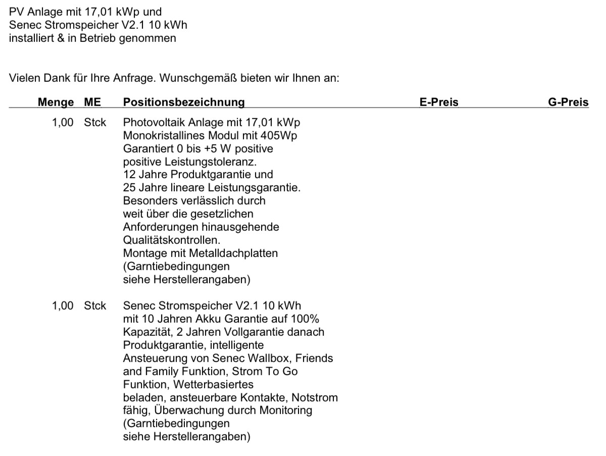

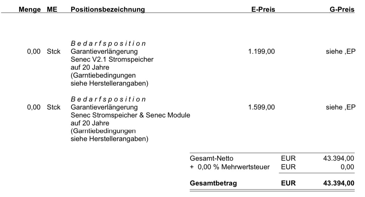

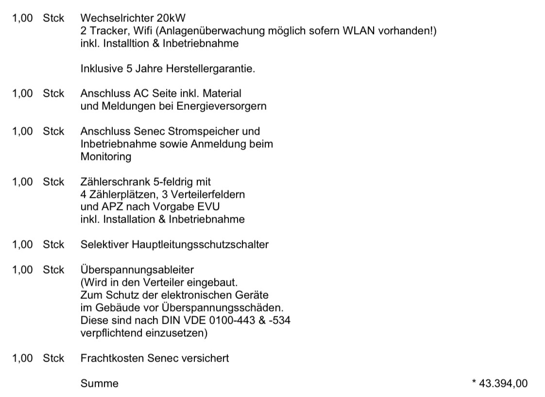

I would like to share an offer I received two months ago and would appreciate some detailed feedback.
Thank you in advance!

18 Jan 2023 17:04
And how do you assess your own offer based on what was discussed in the previous five pages here?
DaGoodness
18 Jan 2023 17:11
Way too expensive!
And don’t use a Senec storage system.
I’m telling you this as an owner of one.
L
Lennox-L
18 Jan 2023 17:17
halmi schrieb:
And how do you evaluate your own offer based on what was discussed in the last 5 pages here?
If I could evaluate the offer myself – meaning objectively – I wouldn’t be asking here. I have a feeling that the services offered are too expensive. But I wouldn’t make a $50,000 decision based on a feeling.
