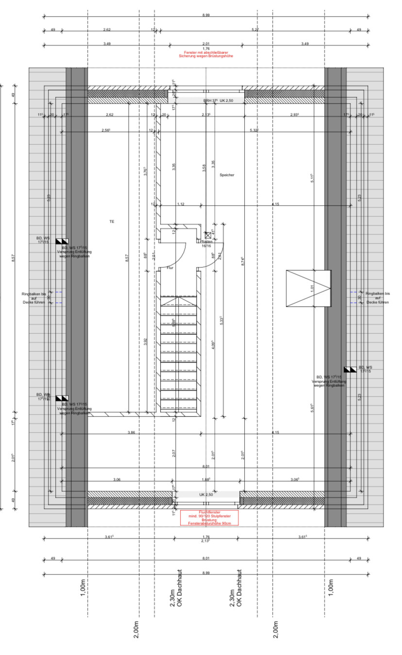

More could fit on the roof. The roof area is 5.5*11.73 meters (18*38.5 feet) per side (minus one roof window on one side only). How much makes sense? I don’t have any experience yet with our house’s energy consumption (with a heat pump). We are still living in an apartment.

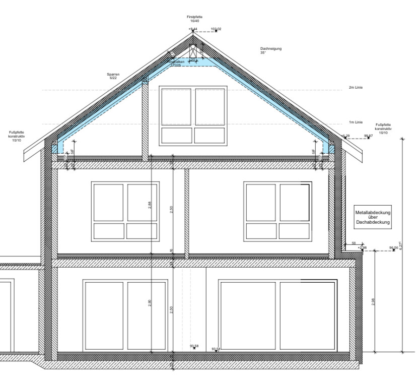

The modules are also slightly overpriced, and the inverter is okay. Please share some clear pictures of your roof.

The roof has no overhangs or special features. Attached are the cross-section and the floor plan of the attic, showing the measurements. We will not be using the storage areas, no interest in them.
Understood, the total price is too high. What is a reasonable price per kWp (net) in the current market? Region Niederrhein.
