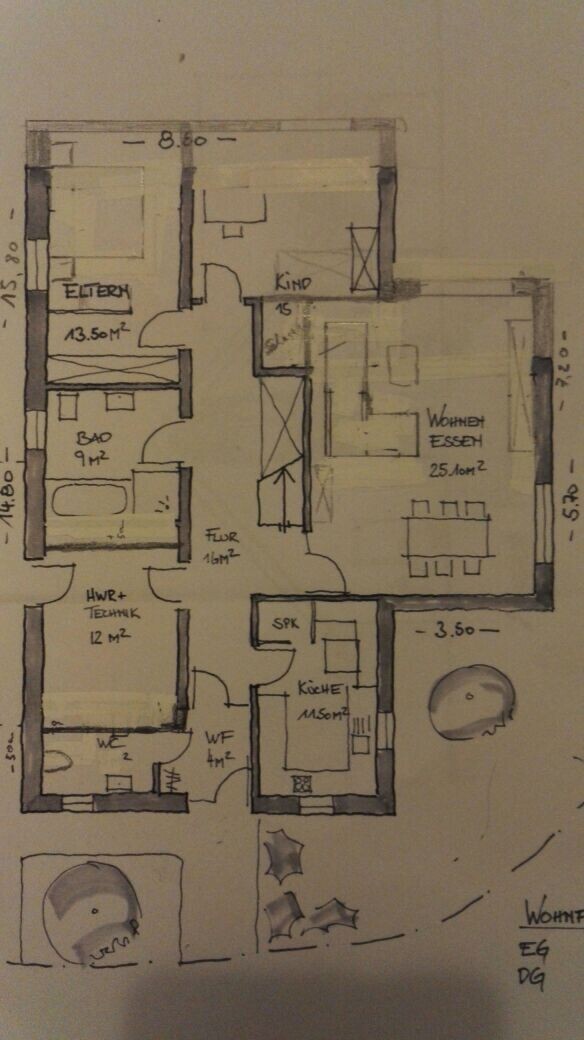

Alright. Today there was an alternative proposal...
Since the children's room will eventually become a guest room/office, I’m not very happy with the location. I want something in between… for now and later…

14 Feb 2018 19:41
Here is the old floor plan slightly redesigned. The extra room is still included for now but will be removed... The office-child room becomes a bedroom and is a bit smaller.

14 Feb 2018 23:23
We have made some adjustments to the new design...
The house will be extended by one meter (3 feet 3 inches) to enlarge the living room...
The shower has been removed from the guest bathroom, leaving only a toilet...

I haven’t read everything here and I’m not sure if this has already been discussed.
Do you really want to keep walking the long distance between the kitchen and the dining table? Why not have access to the kitchen directly from the open-plan living area?

15 Feb 2018 00:56
Uh, well, that’s still going to change … The pantry will be removed, and there will be an opening instead … We also realized that this might not be ideal … This is a new draft and serves as a basis for discussion again ....
