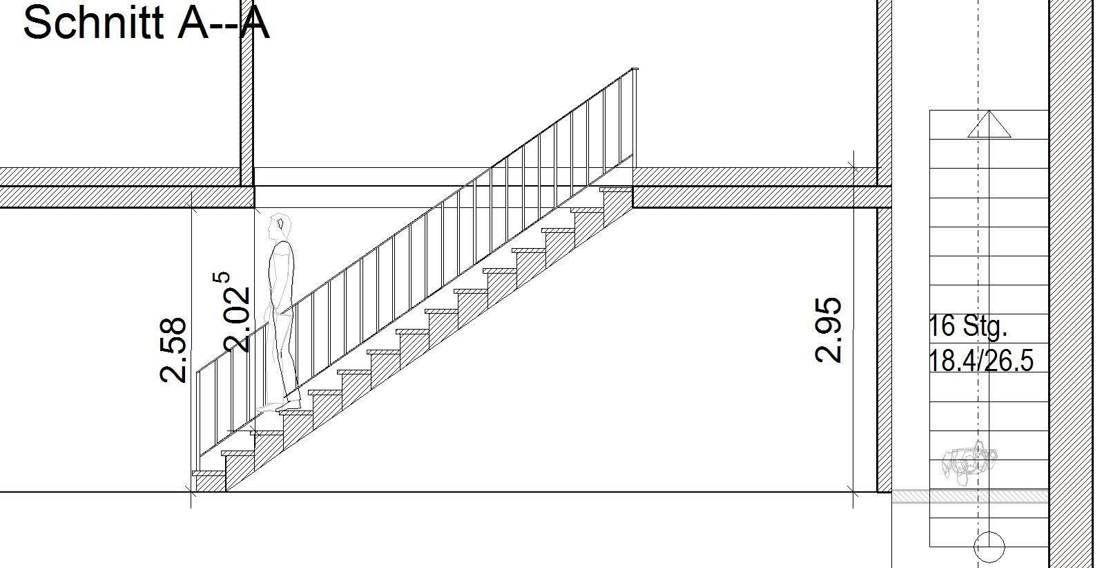

- Upper floor: bathroom modified, larger walk-in shower by “building over” the staircase opening

Wandervogel851 May 2021 11:40kbt09 schrieb:
Building over the staircase won’t work. It’s probably already quite steep, and you want to cover 3 to 4 steps. Here’s an example (although it’s a straight staircase, it illustrates the problem, and only 2 steps are fully built over)
Yes, I suspected this problem as well. Especially since, as drawn, 3 to 4 steps are being covered. I have my first consultation next week, so let’s see what else they come up with.H
hanghaus20001 May 2021 11:45kbt09 schrieb:
This can work quite well. I have something like this. At 1.85 m (6 ft 1 in) tall, it’s no problem. With 3 steps, it definitely won’t work anymore.
