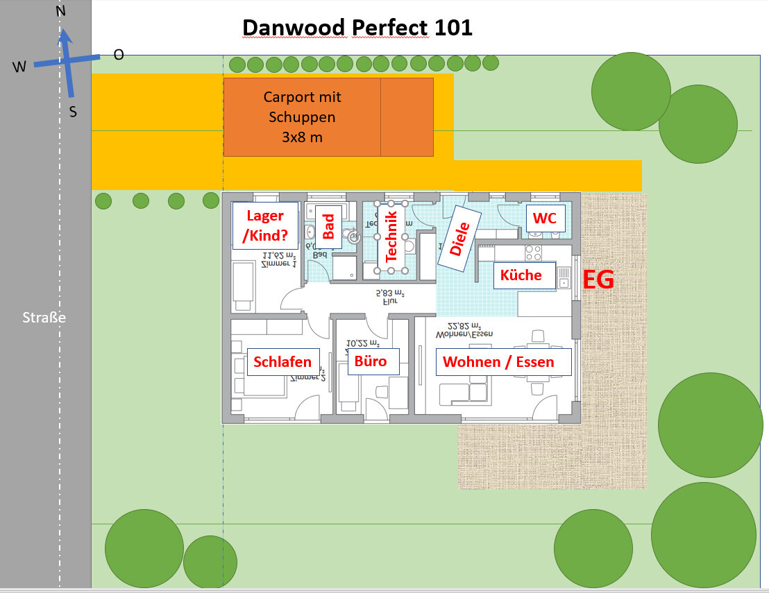

Wandervogel851 May 2021 10:42I have also considered a bungalow before.
I find the angled bungalow 108 from Town & Country and the Perfect 101 from Danwood quite nice.
However, I suspect that both might be too bulky for the plot and later I could have issues with the floor area ratio.
Attached is the Perfect 101 with a mirrored floor plan.
Compared to the standard version, I would consider the following:
I will definitely have this costed out. But especially the topic of a foundation slab built to KfW40 standard is a significant cost factor.
I know I want to build with a relatively small budget, so this needs to be carefully considered.
- Gable roof instead of hip roof
- Possibly increase knee wall height from 8 cm (3 inches) on the hip roof to 75 cm (30 inches) on the gable roof
- Possibly remove the intermediate ceiling in the living room and extend the room height up to the roof slope
- Possibly add a triangular skylight on the gable side to brighten the tall living room

Your mentioned child: a child comes with a partner. Please plan her in as well 😉 This house is a starter home for a young family. The older the residents get, the more cramped it becomes, as everyone develops their own hobbies that usually require space.
If the future is uncertain, I wouldn’t build a house that’s too small; rather, only build one with sufficient options or don’t build it at all.
Wandervogel85 schrieb:
And before anyone suggests it, I like the direct access from the hallway to the kitchen. I don’t want to carry all groceries through the living-dining room first.
Wandervogel85 schrieb:It’s clear you didn’t bother to read 1 or 2 threads about floor plan discussions. No one ever said it makes sense to walk through the living room or to misuse a living room as a passageway, so no one will criticize what you just brought up.
Just as little do I want to have to walk through the kitchen to get to the living room. I wouldn’t change that.
Wandervogel85 schrieb:It’s not logical because the mentioned 30-year-old didn’t mention any child. I explicitly asked what the future might bring because no one knows what a 30-year-old will do with 2 “rooms.” Right now.
The room usage should be quite logical with so few rooms:
1x bathroom
1x bedroom
1x office, which could be converted into a child’s room,
Wandervogel85 schrieb:Aha, there’s a child mentioned again, but no answer to my questions…
1x storage room, which in the case of a child’s room would become the office.
Wandervogel85 schrieb:None of us mentioned a dressing room! You should be objective and not go into a defensive stance about things that were neither mentioned nor criticized. Just address the questions and criticism raised here, not the ones in your head.
I also can’t imagine why someone would need a separate dressing room. That’s just a matter of taste.
Wandervogel85 schrieb:What hell?! See above. Nobody here is trying to accuse anyone when giving examples or asking questions. Are we bad people? No way!...
What the hell for
Wandervogel85 schrieb:I wouldn’t build this house at all, so I wouldn’t position it. There are plenty of comparable houses that, in my opinion, are better suited a) for a single person, b) for a small family, c) for the plot.
How would you position the house?
Pinkiponk1 May 2021 11:19ypg schrieb:
Do you need 2 copies for the building authority / planning department?Yes.ypg schrieb:
Otherwise, I would consider a diagonal.Very good point, thanks for that.Pinkiponk schrieb:
Very good tip, thanks for that.Well, I mean a diagonal layout, angled driveway entry. It also adds some character to the front garden. You get nice triangular shapes for the flower bed planting 😉W
