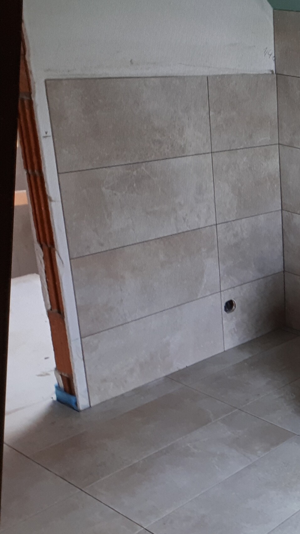

I would like to, but I’m not at that stage yet.
However, I quickly searched online and found a picture.
It looks like tiling is done only up to the door frame.
Interior with gray wall and floor tiles; wall opening for plumbing connection, construction progress visible.

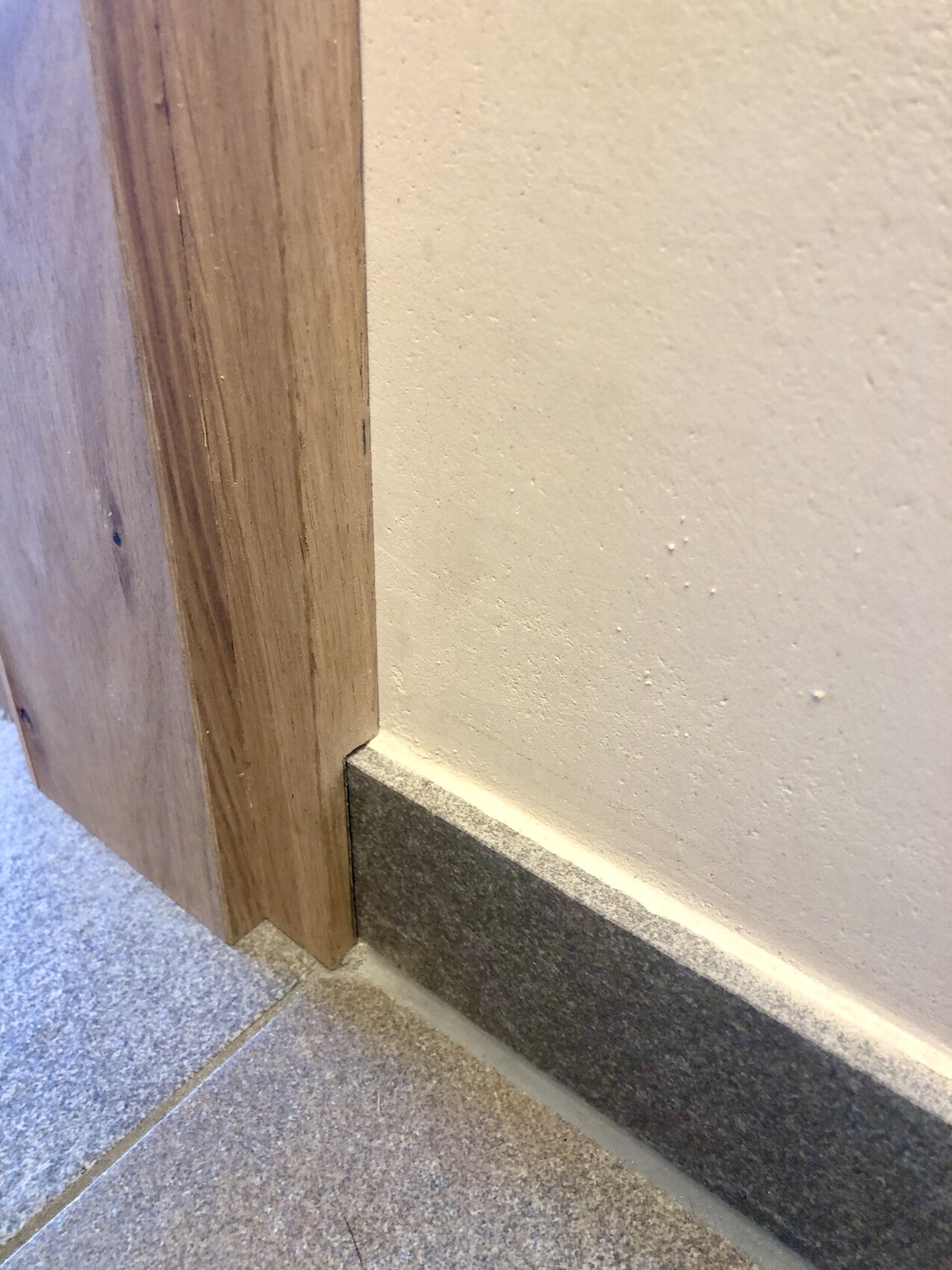

Here is an example of an adjusted door frame. The door is positioned further into the wall than the frame manufacturer intended, and the tiler unknowingly extended the trim edge. So: the frame was trimmed and the tile was cut. It works for us.
Near the door: wooden frame meets white wall, gray baseboard, and tiled floor.

29 Aug 2020 16:54
Hello Hampshire,
thanks for the photo!
cyrix
30 Aug 2020 05:27
Yes, that would be my approach as well. The alternative (cutting tiles on the wall to remove the overhang) also seems impractical to me...
