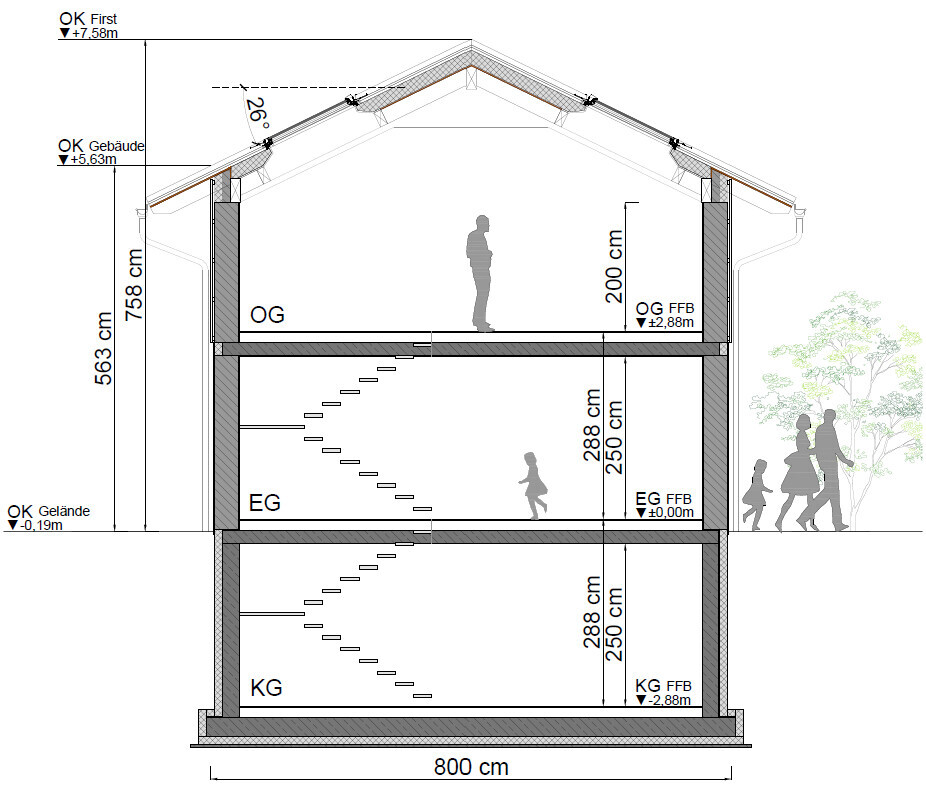

I have a somewhat provocative question. Looking at your basement, it seems to have almost no practical use.
Wouldn't it be more sensible to remove the requirement for a basement and instead plan for a larger ground floor (and possibly upper floor)? The square meters in the basement cost roughly the same as living space on the ground floor. Even if you have a smaller plot, there should still be room for a "bigger house." This could result in a more comfortable living space that is still more economical.
So, I think we should start over.
The walk-in closet on the upper floor is a problem. What is the point of that niche directly above the chimney shaft?
The office with the knee wall at 200 cm (6 ft 7 in) ... those will be poor-quality windows. When you enter the office, you won’t be able to see out the windows because the top edge of the glass will be around 150 cm (5 ft) high.
The dining table and the potential fireplace are too close to each other. If you’re sitting at the dining table and the fireplace is on, it will simply get too warm.

Looking at your basement, it barely has any practical use. Wouldn’t it be more sensible to remove the “basement” requirement and rather plan a larger ground floor (and possibly also an attic floor)? Yes, the 11ant basement rule is often conveniently overlooked.
Baumweg32 schrieb:
Solid construction, modern, no Poroton bricks Those are actually two separate fixed choices that I consider unwise: construction method and specific wall material. Make the choice of construction method only after the >soft phase during the >proofing stage, and then follow the >stone mantra.

Unsorted Thoughts:
Topic 1: The Walk-in Closet
- A central but unanswered question is: How large should/must the home office workspaces be?
- How much closet space is needed?
These two questions are connected. At the moment (unfortunately), I am assuming that the wardrobe space upstairs won’t work and will just be a waste of money and space. The room is simply too small to be used effectively. This can be changed, for example, we planned not to have wardrobes in the bedroom and accordingly made the bedroom smaller. Instead, we have a larger walk-in closet. Some space might also possibly be taken from the home office areas.
Topic 2: Financial Planning
- Fireplaces are expensive. If you love fire, great, it is your dream home after all. However, even KfW 55 energy-efficient houses tend to overheat quickly due to fireplaces. People around me who built with fireplaces in recent years hardly use them—and if they do, then very sporadically.
- I would carefully consider whether a basement investment is justified by the benefits. The plot does not require a basement. A basement is a major investment.
- Cars can survive outside in the fresh air or under carports. Double garages are also quite expensive.
Topic 3: Knee Wall:
- If not dictated by the building regulations/planning permission (which in this case does not apply), I would avoid using this knee wall area. Either make it tall enough to have a good outside view even with shading (usually possible from about 240cm [8 feet] knee wall height, or two full floors), or go for the classic one-and-a-half-story design with a low knee wall, steep roof, and dormer windows. When planning, in the line of sight on the upper floor, when standing, you usually only see the wall ahead.
Topic 4: Kitchen:
- A somewhat provocative idea: door directly between the entrance area and kitchen instead of in the hallway. The door as currently planned is an accident waiting to happen. At some point, someone will run into the door. And if the goal, I quote, is "We want a generous entrance area to avoid future frustration when entering the house and not knowing where to put the groceries," then I think... okay, then follow through consistently and avoid accident hazards. (And if you want to see the garden from the stairs, an interior window can also work. The upper kitchen door is directly in the line of travel between the stairs and the living area, which must also be passed to get to the bathroom. Alternatively: a glass sliding door with some frosted elements.)
