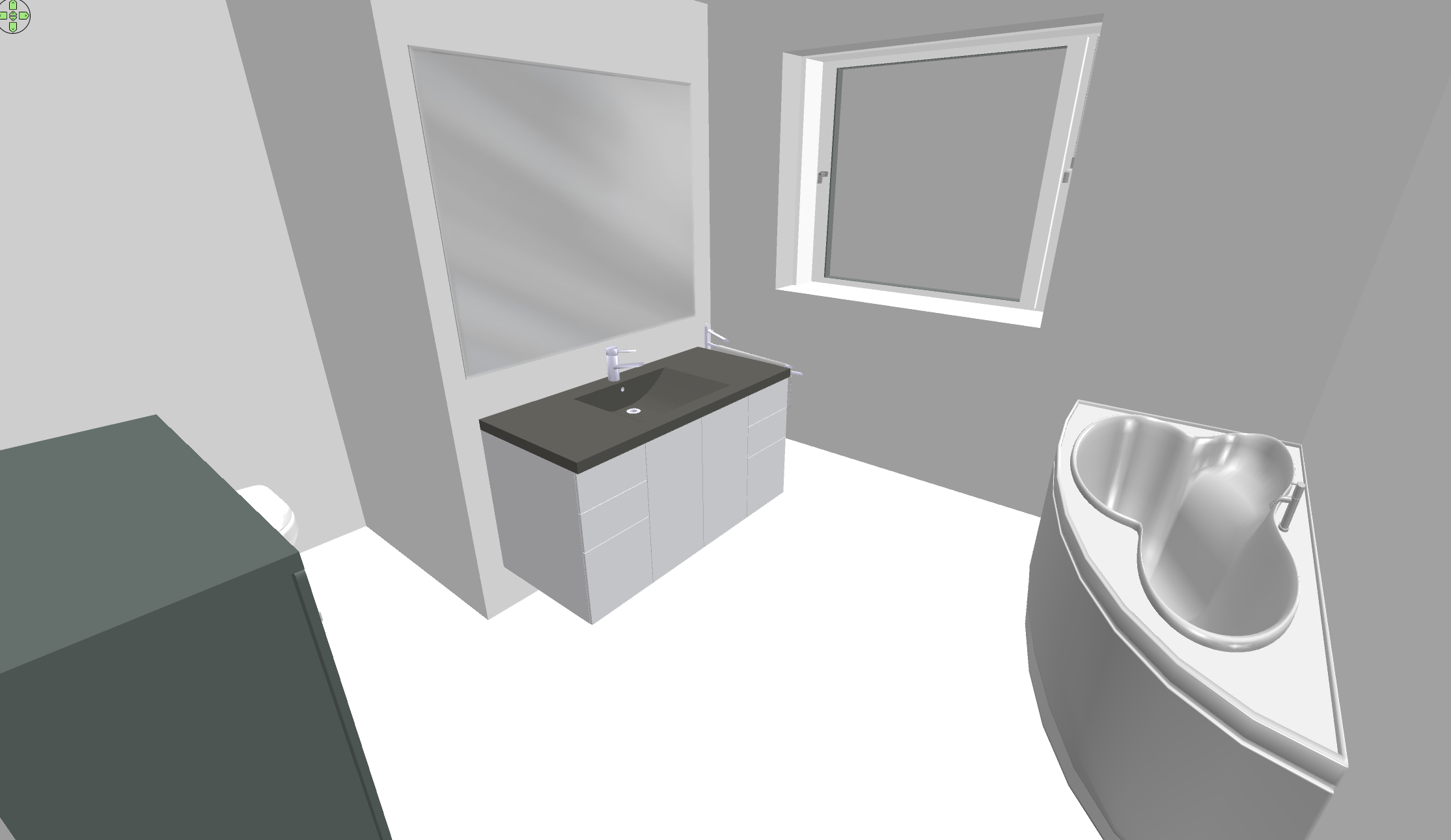

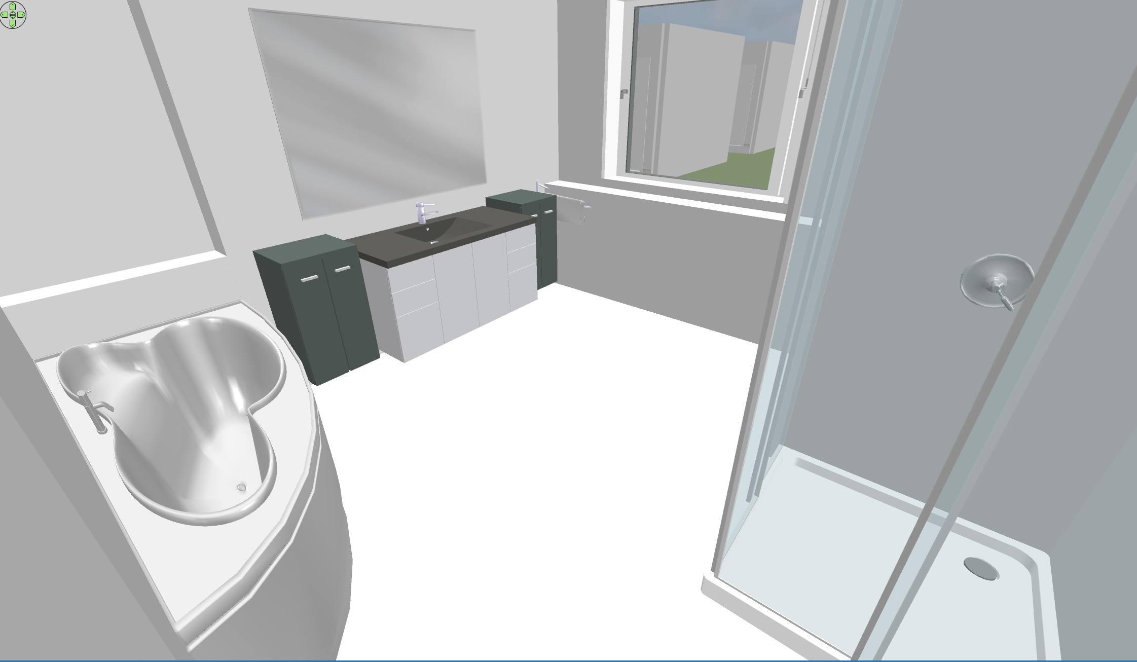

VielleichtBau12 Mar 2026 00:54Hello,
It is important to me that at least one person can be at the washbasin while another is showering. This requirement is definitely met in the L-shaped layout and in option 2. Therefore, all solutions that simply install the sanitary fixtures along the walls are ruled out.
In this solution, the bathtub must be rounded, otherwise the entrance would become too narrow. Personally, I don’t like the entrance to the bathroom here. In my opinion, the shower makes it feel too tight, and you end up walking straight toward a wall—even if it is only made of glass.
If nothing better comes up, I will go ahead with the following L-shaped layout:
With the known slight narrow spot at the shower now.
I would probably arrange it like this or something similar
