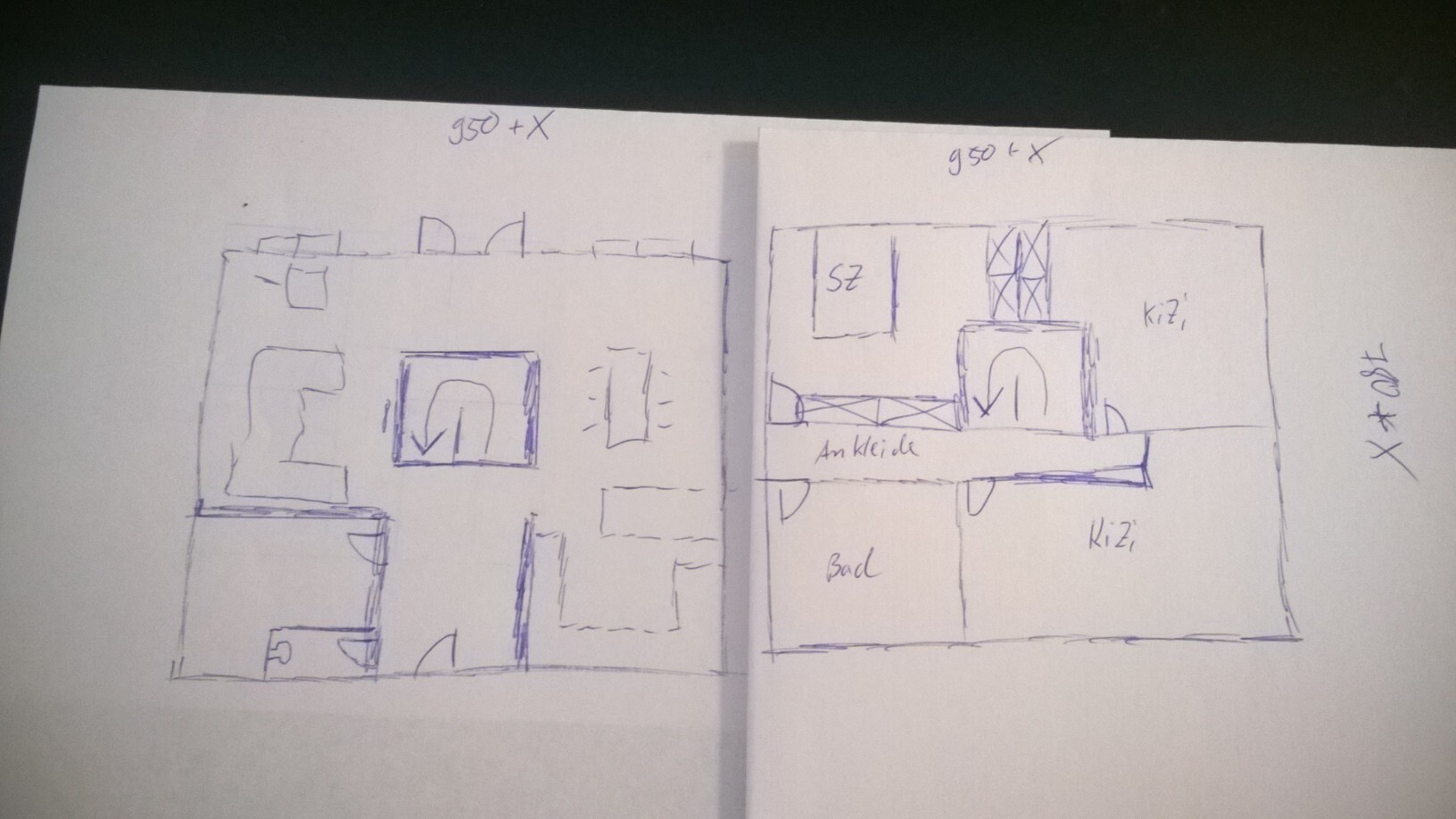

New attempt, in my opinion completely independent of the previous versions:
I would design the hall-to-living area and hall-to-kitchen/dining area passages without doors. Windows are not planned yet. The layout of the two children’s rooms (one larger? the other smaller? etc.) is also not final. Possibly have a corridor running through with large windows on both sides. The walk-in closet itself will also not have a door (the exact wall placement there is not yet final).
If you think doors between the hall and living/dining area are necessary, I would consider sliding doors for those. Opening toward the hall, and then move the door to the utility room. Also, in my opinion, the front door swings the wrong way. The other way round would be better, with a coat rack and shoe storage right inside. The exterior dimensions currently exclude external walls, so about 70cm (28 inches) need to be added. That would make it approximately 1020 x 850 cm (402 x 335 inches). With this floor plan, I would consider a gable roof (possibly knee wall height 140cm (55 inches)? Roof pitch 35 degrees (°)?). I actually find bedrooms where you sleep under a sufficiently high knee wall quite cozy.
