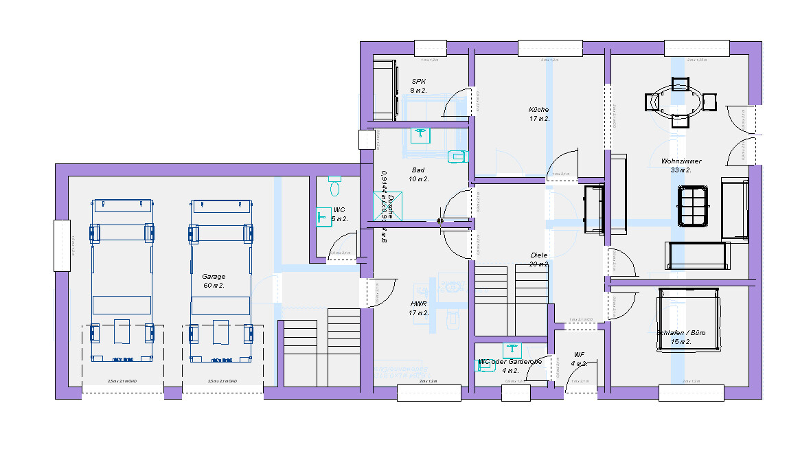

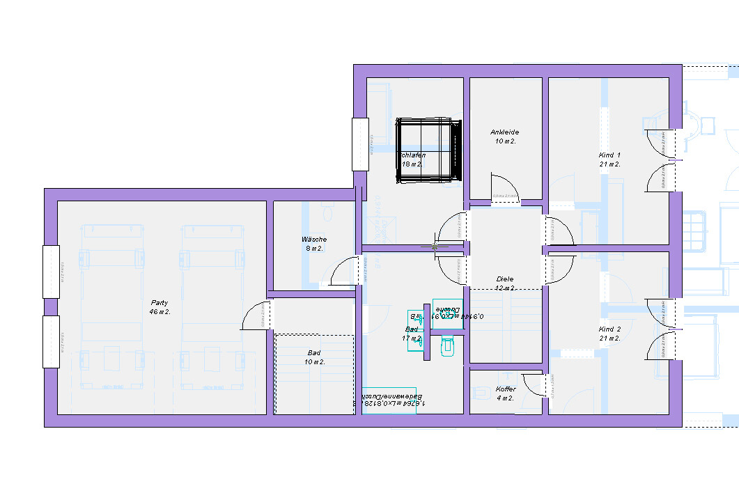

So, these are quite a lot of requirements and will definitely require an iterative process of gradual refinement.
I just started sketching freely, and this is what came out.
I ignored the bathroom layout—that can be done by others. These are all sketches and should be understood as such. Unfortunately, I wasn’t aware of the large space requirement in the garage (workshop, etc.), so that area was scaled down. Certainly not a masterpiece, but maybe it offers some new ideas.
The square meter figures are unfortunately quite approximate. The software always measures from the center of the wall! I assumed 0.4m (16 inches) for exterior walls and 0.2m (8 inches) for interior walls.
Um, a small mistake: the room above the garage stairs is not a bathroom but the stairwell.
