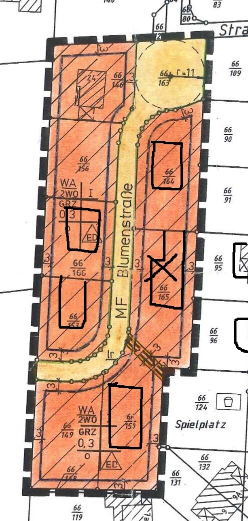

The site plan including the property boundary is provided just to help visualize the dimensions of the plot.
Attached are the floor plans.

So north is on the left? So south would be on the right and west at the bottom?
What surrounds the property on all sides? Maybe try drawing a sketch.

Are there already occupied properties to your right? How far are the houses roughly from your property boundary?

Slammer090914 Dec 2014 14:24I have marked the neighboring houses on the plan. The area is fully built up around us; we are building in a gap between existing buildings.
