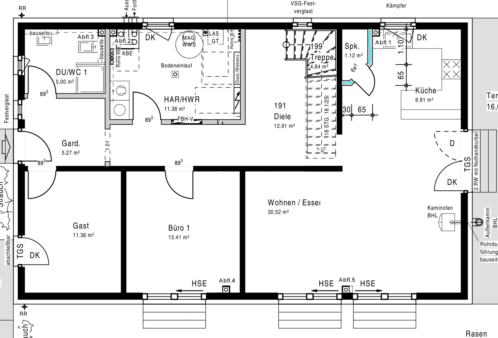

I have purchased a Massa house and want to enlarge the kitchen.
For this, two small walls are to be removed, and the pantry will be eliminated there. It is marked in blue in the pictures.
If I understand the structural engineering correctly, these small walls should not be load-bearing.
Do you have any tips on the best way to proceed here?

hausbauen101 schrieb:
If I understand the structural analysis correctly, these small walls shouldn’t have a load-bearing function.You are probably right: the dashed walls seem to have load-bearing properties, while the white walls do not.hausbauen101 schrieb:
Do you have any tips on how to proceed best here?I think this wayhausbauen101 schrieb:
I am currently taking it slow and steady:You are definitely on the right track for a DIY project. I don’t have a better suggestion.By the way, it’s quite clear in this floor plan that inserting a pantry usually compromises the space. New homeowners should consider this carefully instead of forcing the kitchen layout and ruining the room.
Alfredlima2 Feb 2026 14:13It would be quite unusual if these walls had load-bearing properties. As ypg already mentioned, they are also not shown with dashed lines, which reinforces this assumption. A pantry can also be incorporated with a practical kitchen layout.
