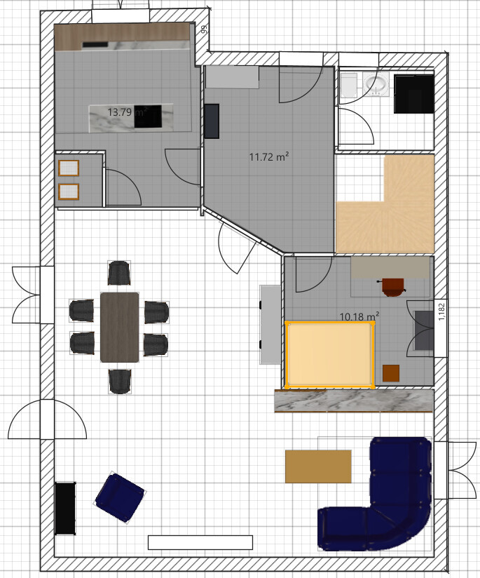

This is probably why the Schwörerhaus joint is located at the floor transition height.This joint can also be eliminated upon request for an additional cost. Above all, the upper floor is visually separated using different materials.So, after some time I wanted to give an update. We have had discussions and visited one supplier; the next visit is scheduled for Sunday. Although we already liked the floor plans to a large extent, not everything we wanted was included, so we sat down ourselves and designed something. I would appreciate any feedback, especially suggestions for improvement. We haven’t planned the windows in detail yet; there will be more in the end, but for now, the focus was on the room layout. From the bay window on the north side, a canopy is planned to extend over the entrance. We have not planned the first floor yet; we are currently concentrating on the ground floor (because it is more complicated to plan). Many thanks in advance!

We haven’t planned the first floor yet, we’re focusing on the ground floor for now (because it’s more complicated to plan). Usually, the ground floor is designed based on the upper floor, not the other way around. And the staircase is one of the main, if not the key, focal points.

We haven’t fully planned the windows yet; there will probably be more in the end. Windows are part of the rooms. Adding them on later won’t look good—and they need to match the upper floor.
P.S. Sloped walls are almost always problematic in design and usually only a last resort to hide issues. And one more question: What kind of rooms are planned here on the ground floor?
The original post https://www.hausbau-forum.de/threads/grundriss-planung-unbedingt-vor-beitrag-erstellung-lesen.11714/ is missing... you are not in the area of floor plan design, but only construction planning.
Site plan, surroundings, floor plan labeling.

hanghaus202324 Oct 2025 20:34The providers you mentioned must have good floor plans. Why do you want to draw something yourself here?
A 13m (43 feet) by 9m (30 feet) layout is not that uncommon.
First, show the plot of land with its surroundings and, ideally, include the building permit / planning permission as well.
