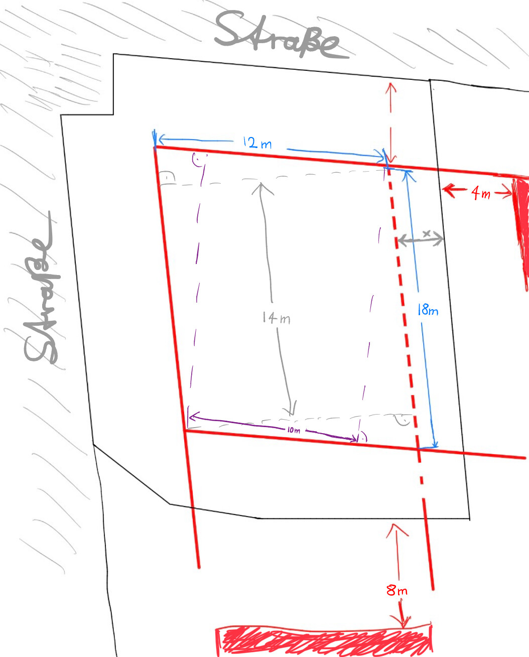

1689owen21 Oct 2025 15:17
I’m checking in after a longer “break,” as the experienced ones already predicted:
Rübe1 schrieb:
zaubert, according to which:
[Next month decide on general contractor]
is completely unrealistic alongside the costs. Unless you want to take a hard fall...
We definitely didn’t want to fall on our face. Still, we’re feeling a bit lost (though it is slowly getting better).
We have completed several agreements with construction companies and architects; some are still ongoing. A plan that considers both our financial expectations and space requirements is still missing. However, we hope we now have a clearer idea of what is important to us.
-I’ll fill out the list that would have been really helpful at the start and report from the preliminary decision as well.
-I’m also attaching rough sketches of the plot [ERROR IN THE GREY 14 IN THE MIDDLE, SHOULD BE 16] (regardless, all figures are quite approximate) and the planned number of floors/setbacks.
-Some things are probably still missing – so please feel free to ask!
-At the end, I’ll list some questions and ideas for the next steps.

Why is the design like it is now?
The II + attic idea comes from needing a certain number of rooms. It’s also appealing because in case of cost issues, parts of the attic could be finished later by ourselves. Originally, we considered II + stepped floor with a roof terrace, but that was more expensive in many offers. We can all live with the pitched roof as long as there is enough headroom in the center of the attic. The pitched roof also offers storage (knee walls, loft space). A basement is not affordable, and with II + attic and garage/shed, we’d at least have space for all our stuff. Of course, I + attic or II without attic could be options too. But we don’t like I + attic if there’s not enough knee wall height (we want to be able to stand everywhere), and both I + attic and II without attic require bigger floor plates, which reduces garden space and increases roof area (and costs). We’ve also discussed this with architects – I don’t remember all the reasons offhand, but they also tend to prefer II + attic.
The driveway should be about 3 meters (about 10 feet) wide, as a setback distance, so as narrow as possible because the area receives little sunlight. The N/S orientation in the sketch is incorrect; south is roughly to the left.
Number of floors is not a major issue as shown in the profile if the roof ridge runs parallel to the driveway. Then the setback distances can be calculated as (3+3+1/3*4)*0.4=2.94, for example.

Now I wonder, what exactly does the building preliminary inquiry concern, who requested and commissioned it? Was it done before the purchase? Did only one person buy the plot and does that person sell one half to the other? Does the preliminary inquiry concern a single-family house or a semi-detached house? Is there already a design? Will the plot be divided exactly in half? What is the plot orientation? Was the orientation considered in the preliminary inquiry or was it simply based on site coverage and floor area ratios? Were parking spaces requested? How many parking spaces do you need? How many must you have?
The inquiry aimed to clarify building boundaries and site coverage ratio. See sketch. The plot will be divided along the party wall; not necessarily exactly half.

Sketchy floor plan of a building plot with street names, building boundaries and interior dimensions.

I just saw: the building plot is 12 by 18 meters (39 by 59 feet), is that the plot size for the entire house or for half? I can’t quite figure it out from the “site plan” when they say it should be 700 square meters (7,535 square feet)...
