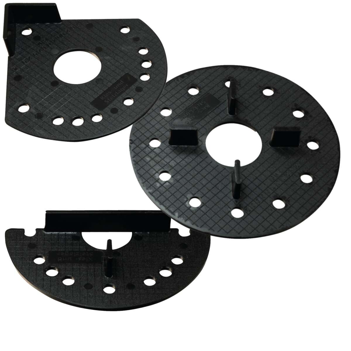

And for the corners, split bed spacers
Black plastic mounting disc set with holes and retaining tabs

If using a gravel bed, keep it to a maximum of 2-3cm (1 inch), otherwise the tiles start to shift and slide.
And for the corners, gravel bed spacers
Black plastic mounting disc set with holes and retention tabs
