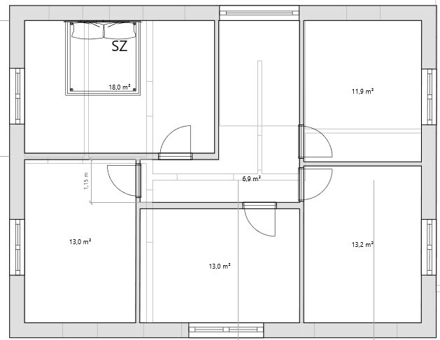

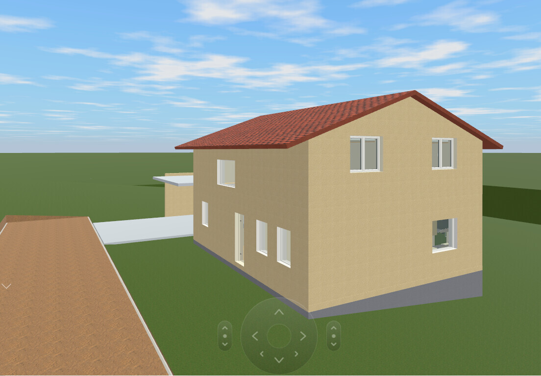

hanghaus20239 Sep 2025 16:22I visualized this once.
@ypg You are absolutely right.
I am now looking at a house measuring 9 x 11 m (29.5 x 36 ft).
![1757426970461.png"]92864[/ATTACH]<br />
<br />
Floor plans are not really my thing, but I gave it a try anyway. Maybe mirror it later.<br />
<br />
<br />
[ATTACH type="full" alt="Detailed floor plan of a house with kitchen, dining area, living room, and bathroom.](/attachments/92865/)
Systems located in the northeast.
Children’s rooms all facing south. Bathroom in the northeast.
The eaves may need to be lowered depending on the reference point. In that case, the central children’s room should get a dormer or a gable window. To break up the wide south-facing facade, a small bay window could also be considered.
I would slightly model the terrain. Delivery material is not that expensive anyway.

hanghaus20239 Sep 2025 16:28Not just possibly reflect. Definitely reflect.
hanghaus2023 schrieb:
I visualized it.
@ypg You are absolutely right. hanghaus2023 schrieb:
Floor plans are not really my thing, but I gave it a try anyway. Maybe mirror it afterwards. Basically, if you have a budget for a 150 sqm (1,615 sq ft) house, a standard floor plan works. However, watch out: without a landing staircase, possibly a quarter-turn staircase next to the front door. And you have to slightly reduce room sizes on the upper floor, possibly planning a small cantilever to fit the layout.
Plan the upper floor first, the ground floor can then adapt.
The exterior visualization is quite accurate. The earth excavation will shape the terrace.
I think @Hanger1 is a bit quiet because the architect’s design is considered somewhat unusual, which doesn’t really cast the architect in a good light.

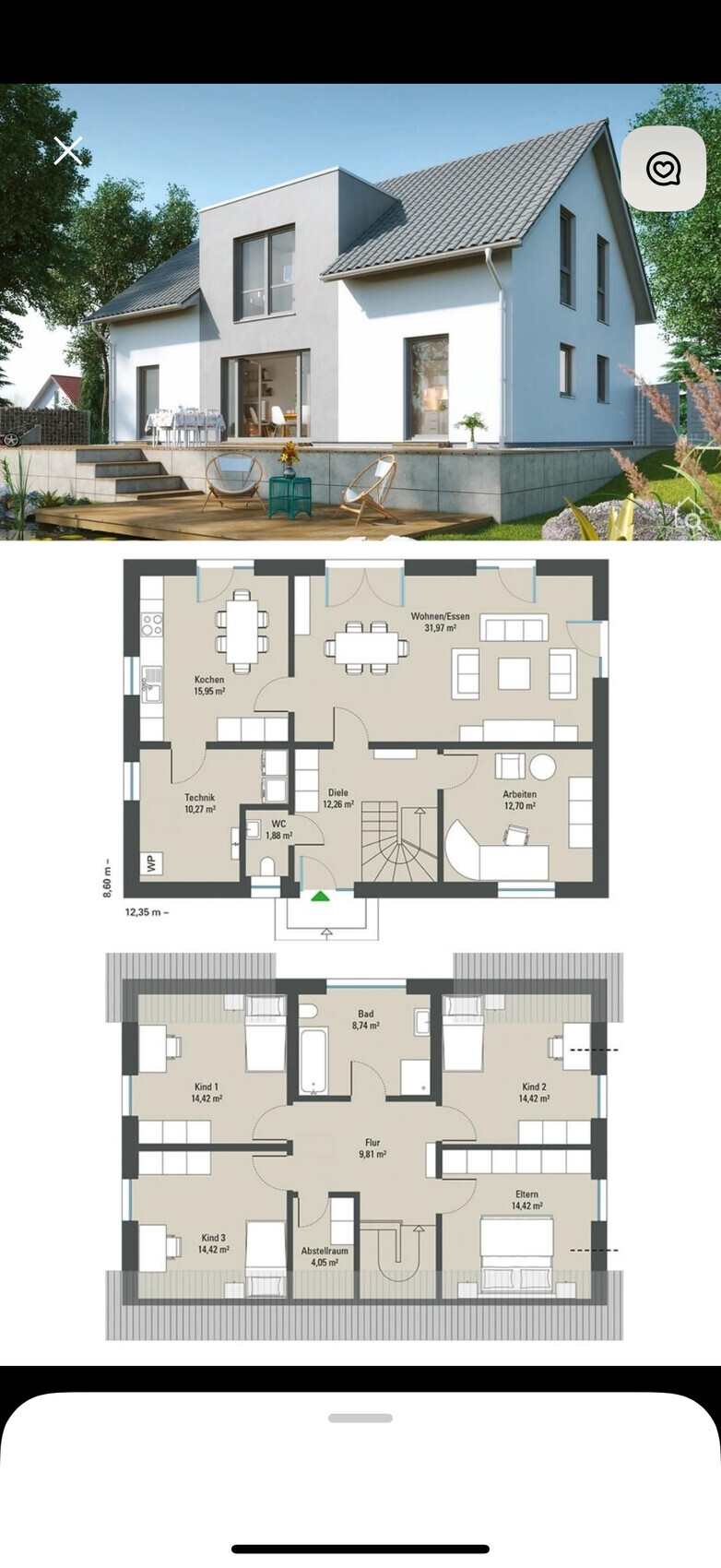

There were many changes regarding the position of the house—higher, lower, split or not. In the end, the budget is the decisive factor again.
You could certainly install a simple carport with corrugated metal roofing, but I think it makes more sense to invest the money in the house itself rather than in a massive roof for a carport. Counting space for two cars easily comes to over 50sqm (538 sq ft), and for three children about 40sqm (431 sq ft).
For the house, I am thinking of the floor plan of Maxime 330 with the version including 3 children’s rooms. That fits well with a house length of 11.60 meters (38 feet).
The garden side would look something like this
[ATTACH alt="IMG_1250.jpeg"]92868[/ATTACH]
And yes, such a terrace design costs money, but it is still one of the most affordable options.
