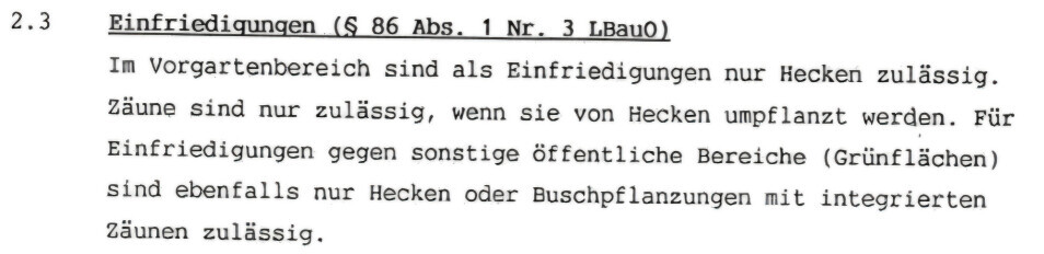

Privacy can also be achieved by carefully selecting plants. There is no need to build 180 to 200 cm (6 to 6.5 feet) high fences that look like prison barriers. Unfortunately, this is becoming more common and really spoils the streetscape. That is probably why your community has the regulation
that you mentioned yourself in post 49.
This means that in areas facing public spaces, such as the street and other open areas, you can build a fence, but you must plant vegetation all around it so that the fence eventually becomes hidden. Consequently, this also means that in these areas the fence must be set back some distance from the property boundary to allow room for suitable planting that will serve as a natural screen.
