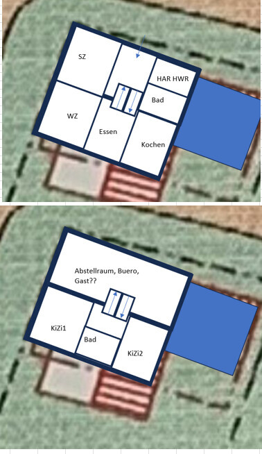

If split-level, then possibly like this.
Thank you for your input. We have sketched a floor plan for the split-level house and have already noticed that it is significantly more challenging, since only about half of each floor’s footprint is available. Often, there is too much length/width for one room and too little for two rooms.Hanger1 schrieb:
We sketched a rough floor plan for the split-level house and already noticed that it is noticeably more difficult because only about half of the floor area is available per level. Often, the length or width is too large for one room and too small for two rooms. Nowhere does it say that the split in a split-level house must be 50/50. However, there are reasons why many planners (myself included – although there are "fans" like @ypg) tend to dislike it. One reason is that it often leads to a strongly offset shed roof.
hanghaus20234 Jun 2025 22:12With 3 levels, each measuring 5 x 11.4 m (16.4 x 37.4 ft), you get about 130 m² (1,399 ft²) of living space. That’s definitely doable. The architect will make it look good for you.
I believe a split-level design suits this plot better than you might think, especially with only a 10% slope on the land. However, don’t think of the classic two-story layout, but rather a more staggered arrangement. This increases the structural complexity since more exterior walls are needed for support, so you have to plan more generously. There are many row houses with split-level designs, but whether they are practical or desirable to replicate is another matter altogether.
That said, I admit a split-level home doesn’t make the most of compact living space. If budget constraints require careful space management, I would not recommend a split-level.
This is roughly how it could fit. The floor plan is quite rough—I just wanted to illustrate the offset levels. My software can’t handle this easily, or rather it’s a huge effort to work with multiple ceiling heights on one floor. My advice: don’t bother unless you’re ready to invest at least a million. A 10% slope is always manageable as a flat build.

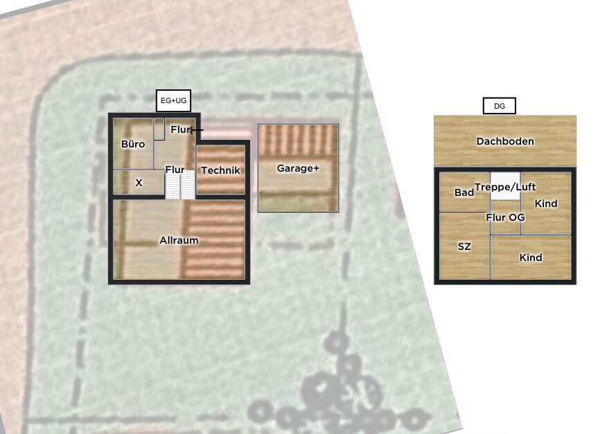

hanghaus20235 Jun 2025 09:41Here are the sketches of the floor plans for the SL. On the lower level are the living, dining, and kitchen areas, as well as the entrance level with bedrooms, etc. Above the living area is the children’s level. With a building footprint of about 11.4 * 10m (37.4 * 32.8 ft), this should provide approximately 130 m2 (1,400 sq ft) of living space. Alternatives are available on the fourth floor. Structurally, I don’t see many issues. The main challenge is the additional work required due to the concrete pour sections.
As @ypg already mentioned, there are certainly very good designs available here without the SL.
motorradsilke5 Jun 2025 09:51hanghaus2023 schrieb:
Here are the sketches of the SL floor plans. The lower level includes living, dining, and kitchen areas; the entrance level has the bedrooms, etc. Above the utility area is the children’s level. With a building footprint of about 11.4 * 10m (37.4 * 32.8 ft), this should provide approximately 130 m² (1,400 sq ft) of living space. Alternatives are available on the fourth level. Structurally, I see fewer problems; the main challenge is the extra work caused by the concrete pouring sections.
As @ypg already mentioned, there are definitely very good designs without an SL here as well. I would then swap the garage and the house and position the driveway on the north side. This way, the southwest garden remains more spacious.
