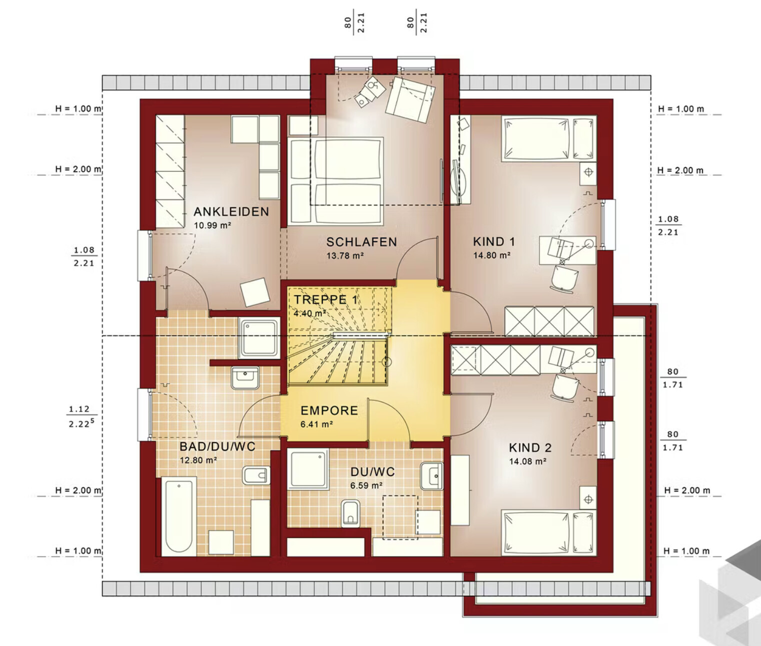

wiltshire24 May 2025 17:20kronos215 schrieb:
However, this ground floor results in the upper floor, which we find quite challenging.I think the upper floor is well designed overall, though I have a few minor differences in opinion compared to the designer: The standard built-in wardrobes drawn in the bedroom, attempting to create a “walk-in closet,” are, in this layout, pointless. With a custom joinery solution, you can create a lot more storage space and incorporate the sloped ceiling area (even above the bed, if necessary). The space under the roof slope can be turned into a very cozy feature, for example with a very low-profile corner sofa section (these can also be found used in good quality) combined with a floor lamp for reading. A bit of artificial lighting is enough there.
The bathroom works fine. The home office could possibly give some space to the child’s room. I would skip the roof window in the storage room. The roof window over the hallway is nice, but if you want real daylight there, plan for at least twice or even triple the amount of glass area (expensive) and keep in mind that it can be tricky to clean (access). Alternatively, there are fantastic light fixtures that can bring light and life to that area. I’m thinking of something like Less’n’More Alien (very cool) or Bulbsquare (which simulates roof windows). This not only saves some cost but also helps keep the house cooler in summer and frees up more surface area for photovoltaic panels, which would be oriented in that direction.
kronos215 schrieb:

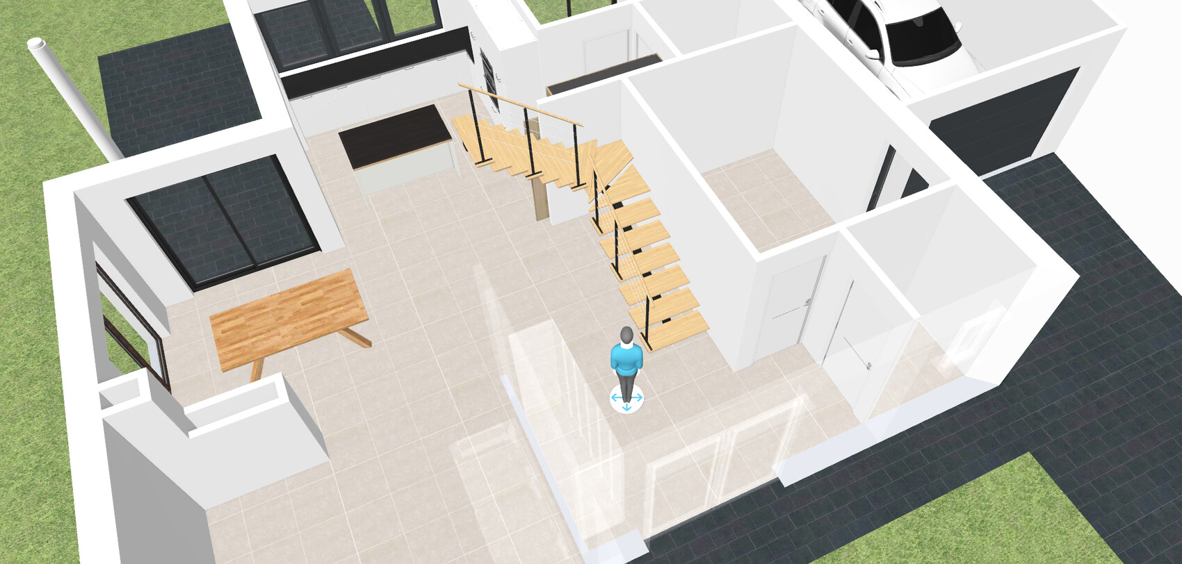

Bien-Zenker, correct. For completeness, I’m attaching the ground floor and upper floor together in this post. Please also add the other attic in post #15.

If the floor plan is rotated 90 degrees to the left, you notice that the ridge direction no longer complies with the site development plan and would need to be changed. [ / ] Looking at the floor plan like this, it would probably be best if only the ground floor is rotated 90 degrees while the upper floor stays fixed. Unfortunately, this means the design would have to be abandoned, because the attic no longer works with a rotated roof, and twisting the ground floor and attic against each other—even though the staircase is quite central here—is also problematic (apart from the fact that then you only keep the price dimension of the catalog model, but lose the advantage of its serial maturity).
kronos215 schrieb:
But any construction company should be able to manage that as a starting point. The construction company you mean is actually the general contractor. And no, they won’t be able to manage this, at best something similarly priced. But a key advantage of the catalog model—beyond having a “checked” calculation at hand—is the technical serial maturity of the design. And the team from company Y simply has no routine with the product of company X. Therefore, it is neither accurate nor advisable to try to recreate a specific floor plan and price-matching house “under a different letterhead.” Different provider, different catalog—no cross-transfers work there.
