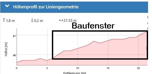

The natural terrain height difference is not 2.2 meters (7 feet), but only 1.8 meters (6 feet), as the re-measurement in the geospatial data portal showed (see attachment).
From the same source, I also created a clearer drawing of the plot with appropriate dimensions (see attachment).

I drew it with 2.2 m (7 ft 3 in). I think the slope from the street over the first 6 meters (20 ft) should probably not be preserved as a steep incline.
hanghaus202321 May 2025 10:58kbt09 schrieb:
I think the slope from the street over the first 6 meters (20 feet) shouldn’t necessarily be maintained as a slope.
The original poster uploaded an elevation plan while I was sketching, showing the first 6 meters (20 feet) as rather flat.kbt09 schrieb:
One must also be aware that this means access to the garden for larger gardening tasks is not free and can only be done through the garage or through the house.Unfortunately, it could no longer be changed ... it will be very difficult anyway due to the sloped terrain.hanghaus2023 schrieb:
The original poster posted an elevation plan while I was sketching; the first 6 m (20 feet) are relatively flat.I know, but that's still about 40 cm (16 inches)... and it’s not yet decided how terraces can be arranged at all in a design like this.Similar topics
