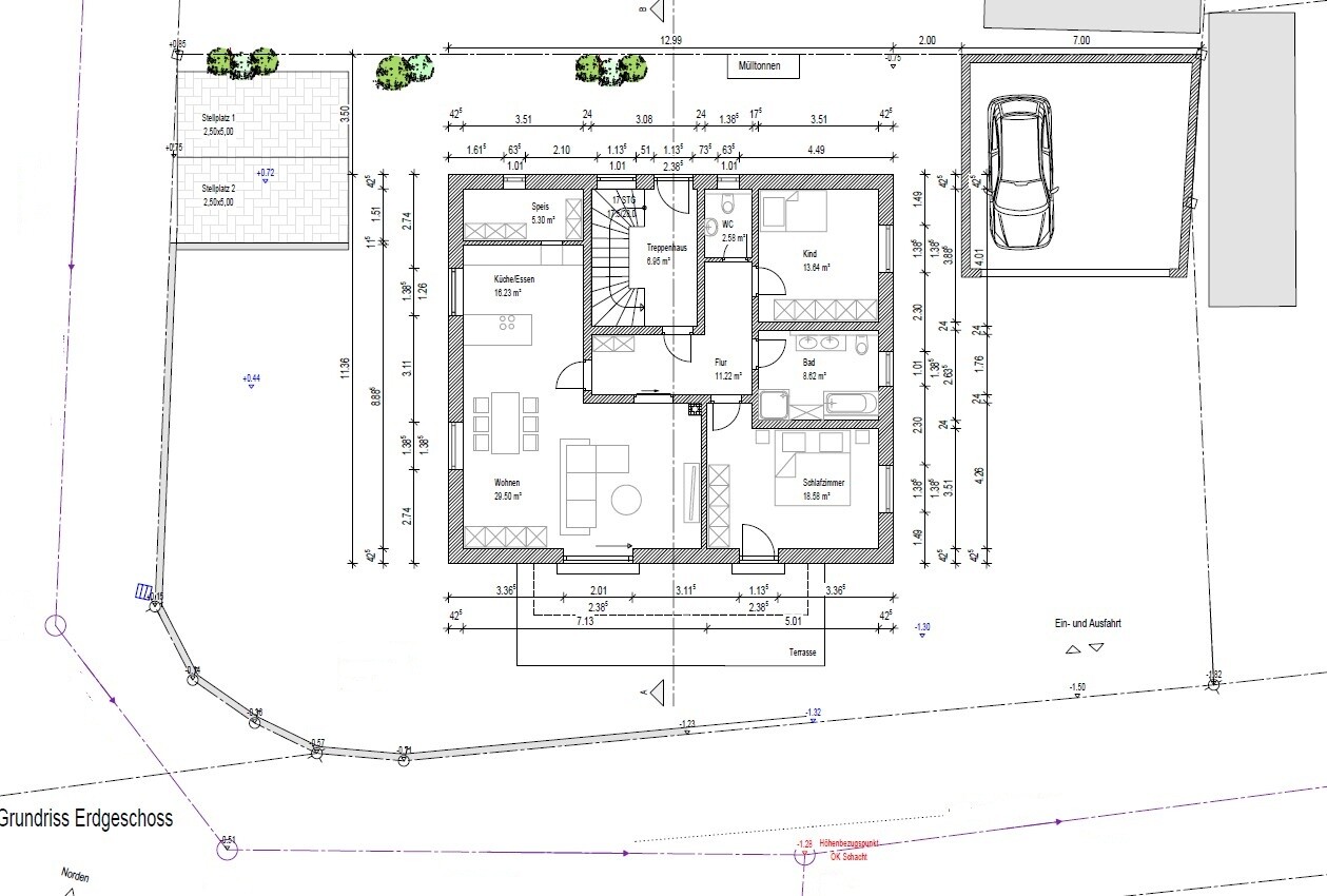

here is the current design of the two-family house adapted to the plot, to help visualize it better.
We have moved the entrance to the north side, which in my opinion fits better now. A guest toilet has been added, and the second children’s bedroom has been removed to allow for more spacious rooms elsewhere.
I am not 100% satisfied with the hallway yet. Maybe you can suggest how it could be improved.
Feedback, criticism, and suggestions for improvement are very welcome.
hanghaus202310 Apr 2025 19:02I only see one apartment and still no questionnaire.
I’m sorry to be so blunt, but this approach won’t get you anywhere.
You want help, but even after repeated requests, you still haven’t provided a completed questionnaire.
In the new floor plan, many of the errors mentioned in the first plan are still up for discussion. Nothing has changed regarding the long, dark hallway or the large bedroom without a practical space for a wardrobe, etc.
