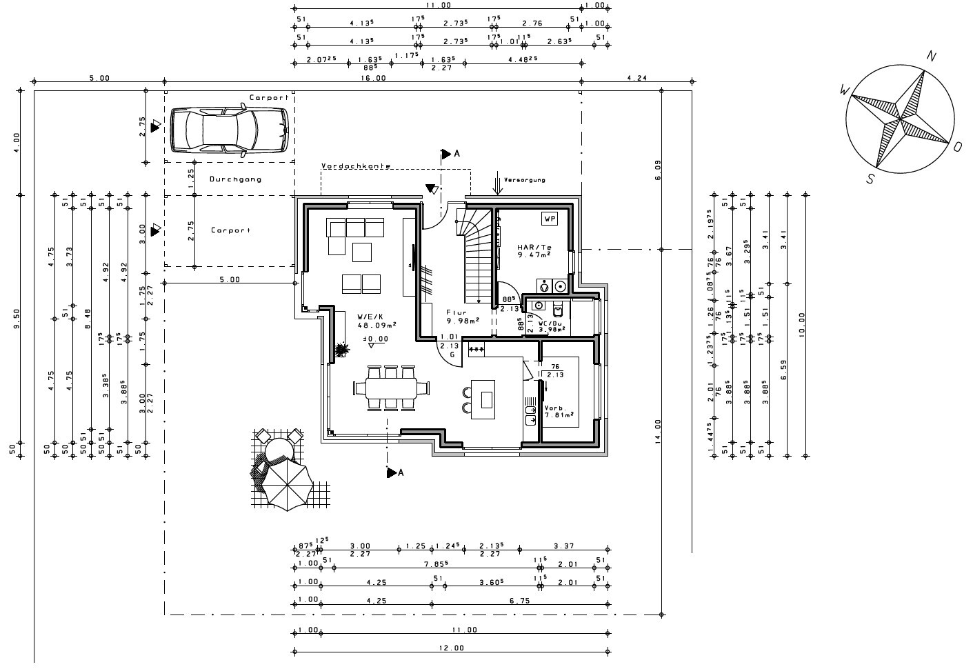

CarlosCalderon13 Mar 2025 07:47The house is planned to be roughly square, about 11 x 10 meters (36 x 33 feet). It will have a gable roof with a maximum pitch of 35 degrees, with the ridge oriented east-west according to the building plan. There will be two full floors, and the attic space will be used as living area for a home office and possibly a child’s bedroom.
The ground floor living spaces are intended to be on the south side (living room, dining area, kitchen). The original plan was to place the carport and storage room in the “corner” with the hook shape, shifting the house in that direction. This would create a garden on the southwest side.
Since this plan does not work, this is the main issue I am asking about here: where should the carport and storage be located so that the house entrance and the following rooms can be arranged appropriately.
I hope I have covered all the questions. I will keep a closer eye on the thread. Thanks for your ideas.

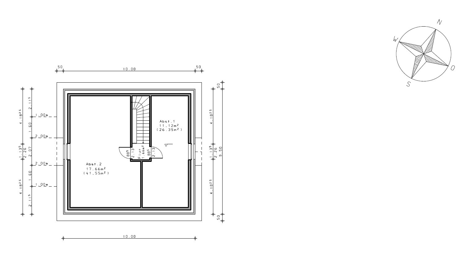

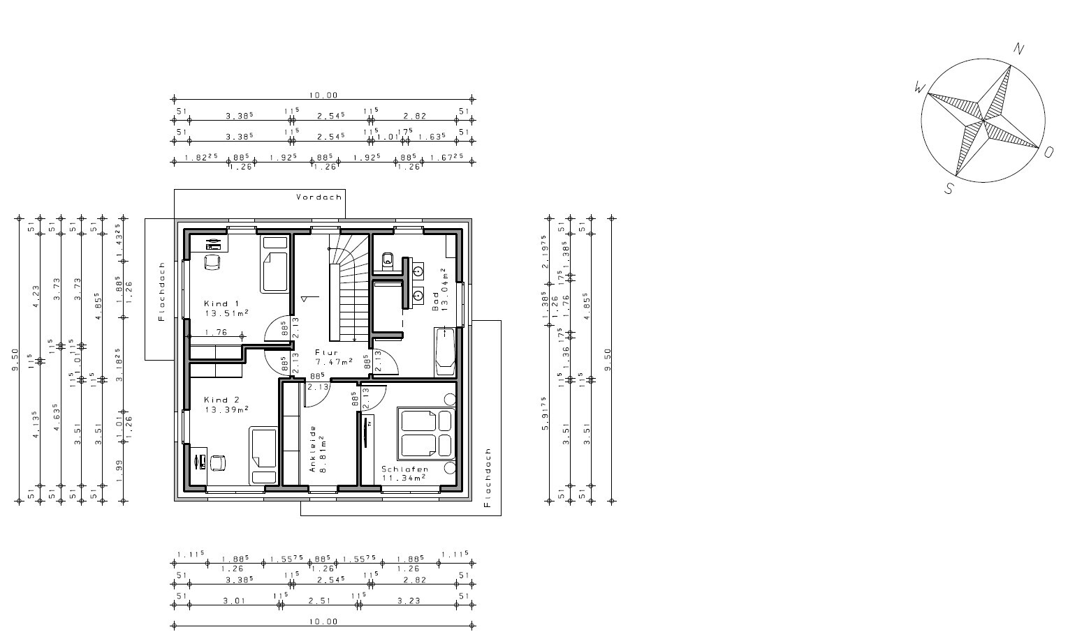

CarlosCalderon13 Mar 2025 08:02Unfortunately, posts can no longer be edited, so here are some images from the draft to help better understand the layout.
The option with the carport in front of the house and a passageway between the cars was a quick solution after realizing that the carport, as originally planned, could not be built. I don’t find it practical, especially with children.
I hope the plans help clarify my description :-D
