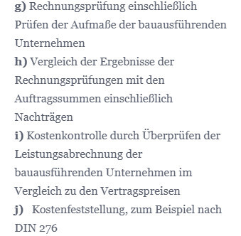

The main question is whether you have any legal claims for compensation. I already recommended a few pages earlier to consult the basic services defined in the HOAI...
So yes, if service phase 8 is commissioned, cost determination must also take place – it is paid for by the client (or at least the architect expects to be paid – regardless of the services actually provided).
Antjeaergert13 Feb 2025 15:41nordanney schrieb:
I already recommended a few pages earlier to refer to the basic services defined in the HOAI...
So yes, if service phase 8 is commissioned, the cost verification must also be carried out – it is also paid for by the client (or at least the architect wants to receive the payment regardless of the work performed).And this could possibly explain an overrun of the construction budget, etc.
How far this goes, I don’t know; however, my main approach against this woman is to demand the services, since she is already urging for the final invoice – and with payment of this invoice, the architectural services would be considered accepted.
