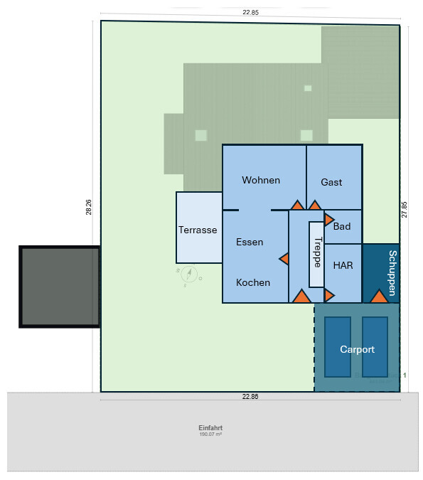

we would like to share our design with you to get feedback and suggestions for improvements, as well as to identify any potential issues.
With the optimized design, we plan to approach construction companies for quotes. All the architects we contacted have long waiting times, and since we need to apply for funding in spring, that would not be feasible timing-wise.

Thank you for the pictures and your experiences, @Arauki11 @wiltshire and @ypg!
I will check with the building authority / planning office and will probably proceed accordingly – I really like how it looks because a high-gloss driveway doesn’t suit our house, and if it proves to be practical, it is a cost-effective alternative.

I would also position the house as far southeast as possible and orient the main terrace to the west. This way, you get a nice view facing north onto the open field and a large, continuous garden. The quiet living area should face north with north- and west-facing windows, as this area is mostly used in the afternoon and evening. The kitchen can face the street, with the dining area having a 3m (10 feet) sliding door towards the west. The living room should be separable by a sliding door. A cloakroom can be placed under the stairs (EBS). The guest room should also have an east-facing window. The bathroom as well. Here is a rough sketch of how I imagine it. The carport is usually allowed next to the street.

So, we have now had some time to think it over, tried out a few things, and I also visited the plot again.
Your idea @Würfel* is very appealing to me, especially the long side of the living area. However, I can’t manage to fit everything in the sketch you drew and still include the upper floor. Does anyone else have ideas?
Additionally, according to the development plan, both carports and garages must be set back 3 m (10 feet) from the street. Roof overhangs are allowed to extend up to 1 m (3 feet) into this area, so maybe there’s a way to work around this by placing the carport support at the 3 m (10 feet) boundary and letting the roof extend beyond? How does this stand from a building regulation perspective?
I also find the design from @K a t j a in post #33 really interesting inside, but for me, the house is too wide. Having a large, connected garden on the northwest side is important to both of us, as well as not being too close to the neighbor’s garage.
Could you sketch that for me, please?
I would now also suggest positioning the house centrally, in a sunny spot, but also with access and views to the north, so the long main side of the open-plan living area faces southwest.
