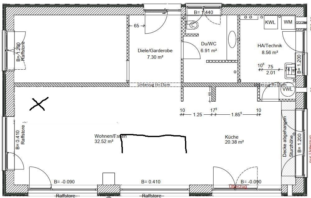

@ypg I’m sharing a plan excerpt here. This shows our ground floor; I have removed the existing stairs leading to the upper floor.
I’m certainly no floor plan expert, so I wanted to ask if this somewhat similar situation might be useful for your designs, at least in part. I wasn’t always sure myself, but since we have now lived here for a while and like it, I think I would do it the same way or similar if I had to limit myself to just one level.
What I especially like is the direct view through the large window right after entering the house, which creates a really spacious feeling and almost brings the garden inside (or so the poet might say). That’s how I wanted it, and I could imagine having an office space there in front of the middle window, for example, behind a half-height wall/divider to avoid looking over the office worker’s shoulder and instead see something like a half-height plant or decorative feature inside the house. I hope I’ve made that clear.
The kitchen/utility room and living room would of course need to be swapped or the entire layout mirrored, or you could place the office on the current kitchen side. But I find the entrance area with the bathroom and the opposite bedroom very practical, though the door to that bedroom could also open from the main living area.
I can easily imagine this here, as I said, just a rough idea or possibly some useful aspects. The total size here is 90 sqm (970 sq ft) and could certainly be reduced by a few square meters without losing any substance, especially since the stairs are still included.
As I said, just an idea, because I’ve thought a few times whether something like this might be suitable for @Newbee-BW.
Using the tool to draw the plan also made it clear why my drawing teacher always smiled at me so kindly. But the neat office room divider is certainly not to be overlooked, just like the cross where an office could also fit. As I mentioned before, I would do this in favor of flexibility and aesthetics with movable furniture or shelving units.

I’m posting a plan excerpt here.I knew we’d hear from you again, Walter!However, the original poster has different needs than you do. Has the room on the ground floor now become a bedroom? It was originally planned upstairs for you.
Because of the different needs, I don’t necessarily see your ground floor plan, especially since there’s also an upper floor, as a suitable design for the original poster.
And it’s not my ground floor plan, nor Silke’s or Nida’s, that is the original poster’s plan, because the conditions, plot orientation, and wishes are different everywhere.

that, for example, a workspace could be created centrally in front of the middle window behind a half-height wall/partition system, so the office worker is not watched from behind but looks at a low plant or decorative feature inside the house.Whether it’s a half-height wall or just plants: it will distract from exactly what you like—the direct view of the garden.ypg schrieb:
Would it be worth it for you if I rework the last plan in a rotated version, meaning kitchen and living area mostly separated like in the last one?The question referred to the fact that the open living area is more or less divided or zoned. In your initial drafts, you had one long open living area. Which do you prefer? Divided or combined?Well, I actually wanted to plan again, but now I have to search through the forum of @Arauki11’s old account.
