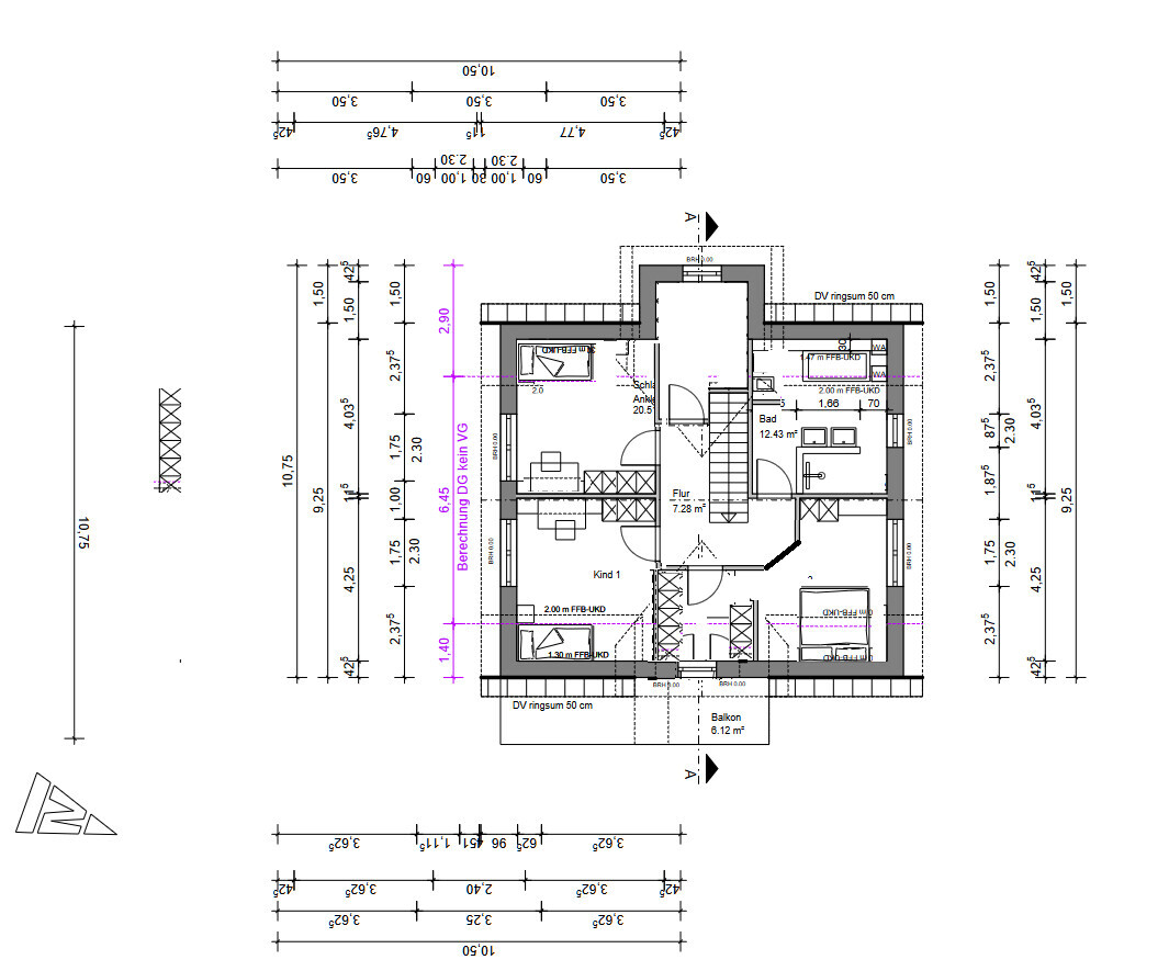

In the meantime, I made a quick attempt to improve the upper floor to pass the waiting time. I just moved walls around in Paint, so it’s not very neat.
I think it looks better, although now I’m not sure what to do with the extra room 😀

K a t j a27 Nov 2024 21:33
Could it be that you mixed up north and south? I’m having trouble understanding that right now.
Putting the bed directly under the sloped ceiling seems questionable to me. How high is the knee wall? Of course, it depends on the bed, but a headboard is often around 1.20m (4 feet) or even 1.30m (4 feet 3 inches) high. You can also specifically look for beds without a headboard. Even when considering the 2m (6 feet 7 inches) height line, it still often causes headaches. That’s why I would either lower the ceiling area or install a board behind the bed so that the bed comes further into the room away from the wall. But then the door gets tight again, and let’s be honest, do you really want to spend your money on this makeshift solution?

Yes, you are absolutely right about rotating. I rotated the plan so that the entrance would be at the bottom. My wife didn’t really like that, so I quickly rotated it back again—this time rotating only the house itself, not the entire plan.
Our bed (bought this year, one of the few pieces of furniture we’re taking with us, besides the table) is 1.10m (3 ft 7 in) high. Currently, the knee wall is planned to be 1.3m (4 ft 3 in) high. The bay window below is designed specifically to allow for a relatively high knee wall.
As I said, I was bored and waiting for the planner. I’m basically battling on three fronts now—the planner (to whom I’ve already shown with your plan that it can be done better), the internet (which advises me to approach things more freely), and my wife (who is disappointed that the house looks different from what she wants and already has no interest in comparing floor plans anymore) 😀. At least I found my version better than the planner’s last version, though yours is still better. But of course, he can also try a version with a different staircase. I also mentioned the staircase in the bay window about a week ago (mostly because of the hallway and the layout upstairs, as far as my imagination went without a design program) when I talked to him on the phone to ask how many rounds and attempts are typically made before deciding to build a house.
