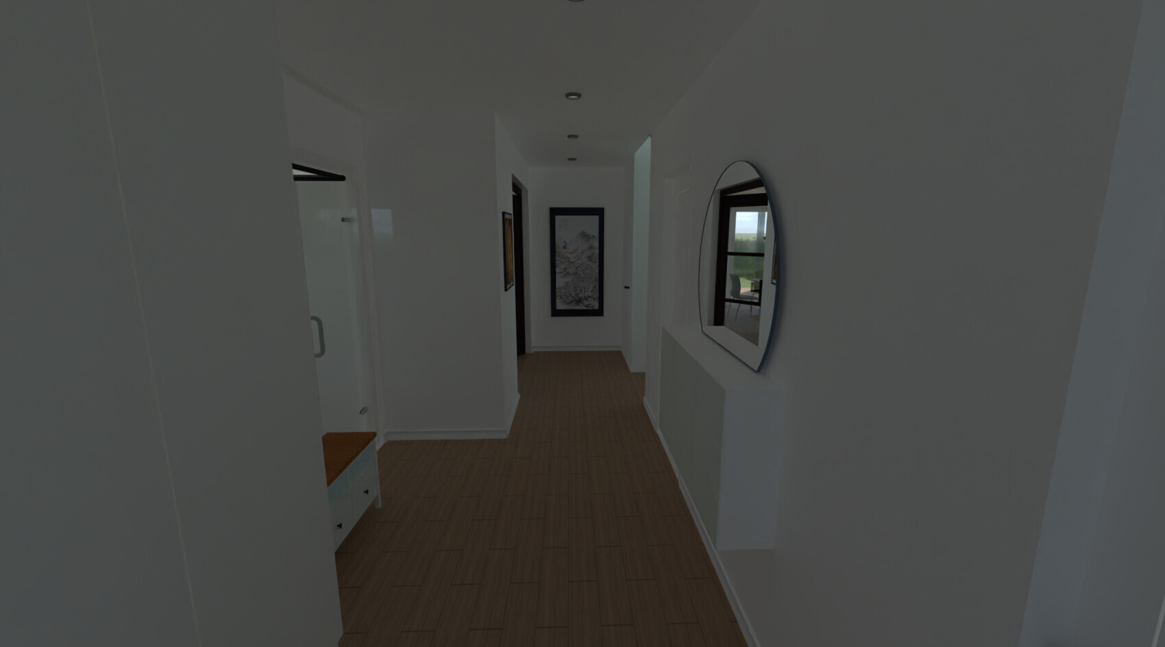

Your thick skin will certainly come in handy. I can also tell you that I find the view into the hallway quite unsettling. It makes you want to turn around immediately.

Your thick skin is certainly helpful. Then I can also tell you that I find the view into the hallway quite dreadful. You’d almost want to turn right back around. I let my computer run for another five minutes and tripled the light intensity for you.

From my point of view, the rooms first need to function well on their own. The hallway is functional accordingly and can certainly be decorated nicely. The hallway should invite you into the main rooms and living areas. I only see a closed-off feeling – it just doesn’t open up. And as you can see, it is very dark.
