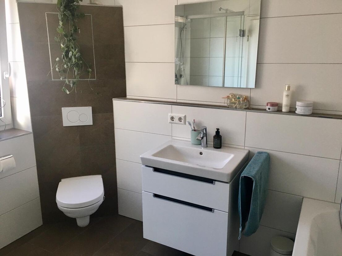

partyoleole19 Apr 2024 10:58ypg schrieb:
April Fools’ Day is already over… wake up from brushing your teeth in the bathroom!I’m awake now, this is what it looks like for me..
The washbasin ends at 1.72 meters (5 ft 8 in), design from 2016.
Okay, but this looks less problematic than it would be in the original poster’s case, because there would still be a wall about 30-50 cm (12-20 inches) in front of the toilet. So it feels much more cramped and "makeshift" overall. I just noticed that this was no longer the case in the last proposal. I still find it a bit odd and believe the bathroom offers enough space for a "nicer" arrangement.

partyoleole schrieb:
Just woke up, this is what it looks like for me...
The sink ends at 1.72 m (5.6 ft), planning from 2016.Tolentino schrieb:
Okay, but that looks less bad than the original poster’s situation because there is still a wall about 30–50 cm (12–20 in) in front of the toilet. So it’s much tighter and more “makeshift” overall.I don’t understand what you mean about the wall and running layout...
I just noticed in the last proposal it was no longer like that. I still find it a bit odd and believe the bathroom has enough space for a “nicer” arrangement.
