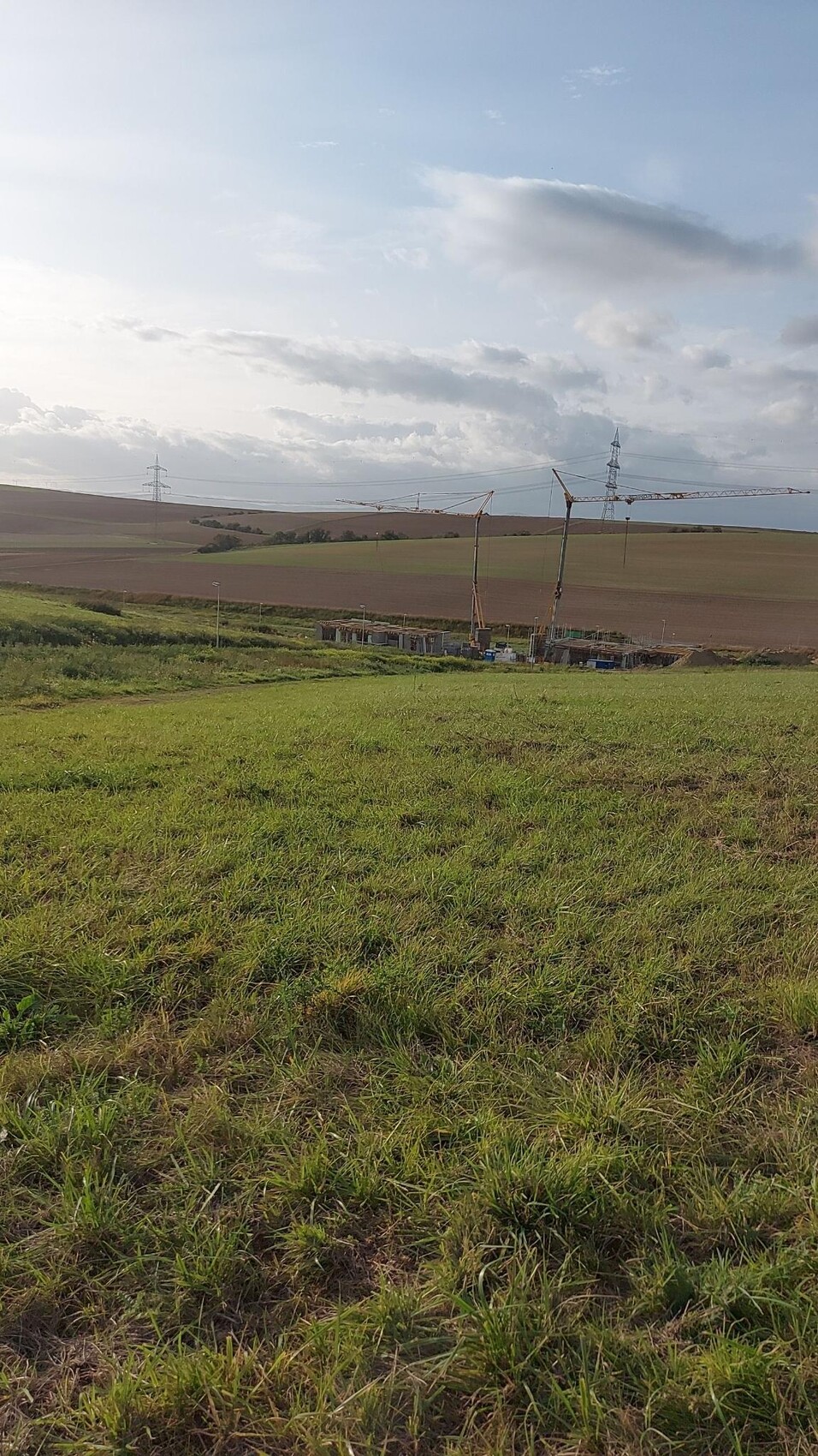

Currently undeveloped, entirely meadow.

The surroundings can be seen in the pictures attached to the original post.
There are currently no houses within a 100m (330 ft) radius. The best view is from the dining room / living room.
