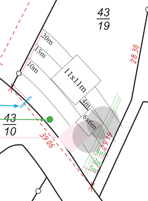

In my original post, I only described it. Attached you will find a picture showing how I would position the building.
Thank you for the suggestion:
For one, it would probably be helpful for others if you could mark the house and its outbuildings on the site plan.
Site plan: 11×11 m building, curved area, distances 4–20 m, measurement lines and arrows.

That’s why I asked for the site plan: are you basically placing the house in mid-air?!
I strongly advise you to stop dealing with naive, amateur ideas and consult an architect experienced with hillside sites.
