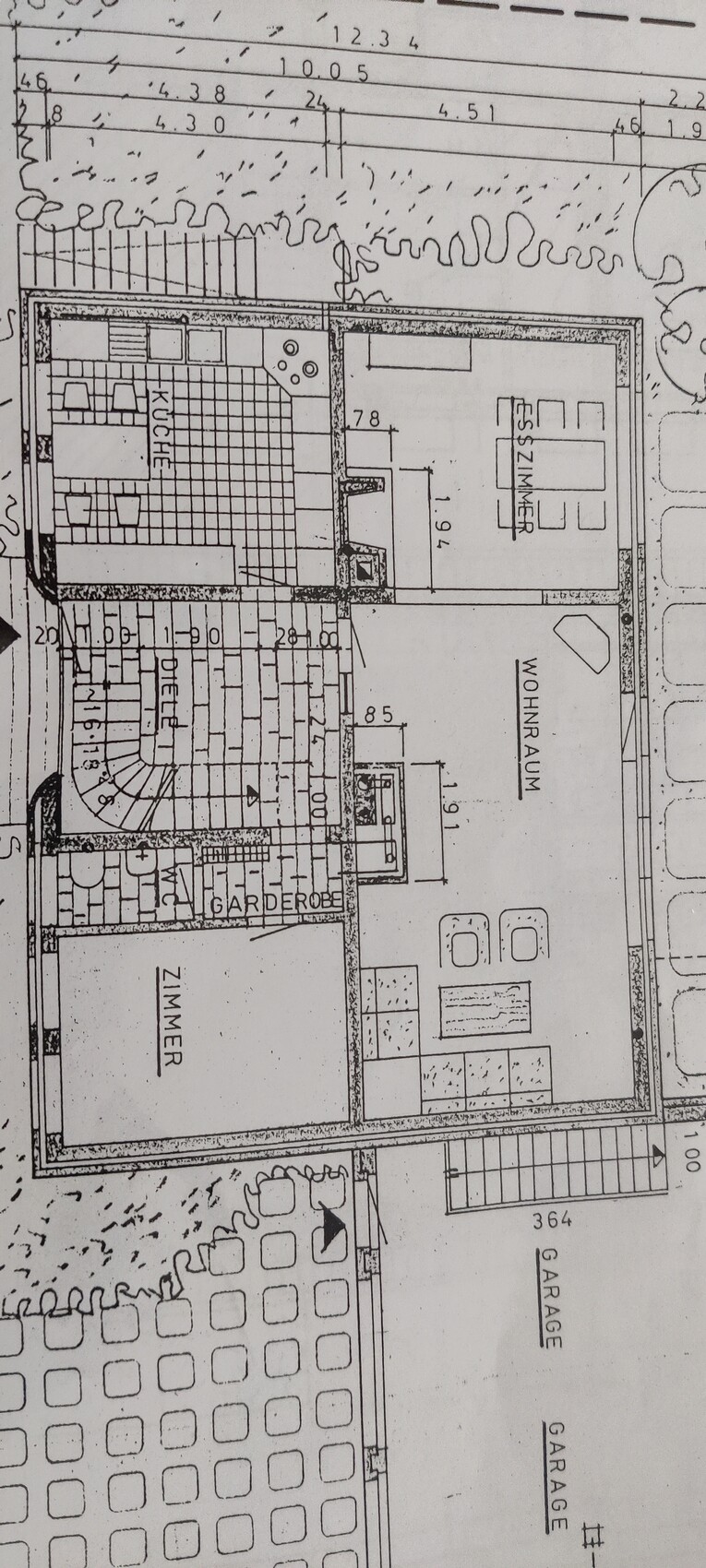

Maybe someone can help me.
We would like to create an opening between the kitchen and the dining room.
The planning is still in the early stages, and a first look at the floor plan has been taken.
There, I found the following symbol, which is unfamiliar to me, especially in this combination.
Does anyone know what it means? It concerns the symbol in the lower right corner of the dining room.
Thanks and best regards
Floor plan of an apartment with kitchen (KÜCHE) and dining room (ESSZIMMER) including tiled floor.

You mean the symbol in the lower right corner of the dining room, right? That should actually indicate a chimney flue, and next to it is probably an "open" fireplace or something similar (at least the facing would suggest that). But with very high probability, the symbol should be a chimney flue.
27 Sep 2023 14:59
Which symbol do you mean? The square with the diagonal should be the chimney, and next to it the fireplace. If you show the entire plan, we wouldn’t have to guess but could draw conclusions instead 😉
Simon-189
27 Sep 2023 15:00
a square or rectangle, diagonally shaded in black, always indicates a floor or ceiling opening. I suspect this is a chimney with a measured seating bench?

I’m attaching the overall floor plan once again.
The fireplace is located in the living room, where there used to be an open fireplace with a built-in seating area.
In the dining room, at this spot, there is only a wall.
On the roof, roughly above this spot, there is a pipe that regulates the air supply for the sanitary systems.
Grundriss eines Hauses mit Küche, Esszimmer, Wohnzimmer, Zimmer, Garderobe, Garage und Garten.
MavGer1811
27 Sep 2023 15:06
Still the first floor.
I'm Bad bottom right is the chimney (counterpart to the living room on the ground floor)
Floor plan of a residential house: two children's rooms, hallway, bathroom, kitchen, storage room, staircase.
