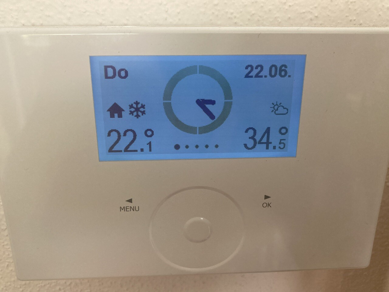

HeimatBauer22 Jun 2023 15:30What do you find most important about the ice storage? The air conditioning in summer?
Here is a recent photo from my home office, with the interior on the left and the exterior on the right.
Self-sufficiency is constantly at 100%.
Yes, exactly, it’s that system people say doesn’t work and wouldn’t even want if it were free—the cooling through the heat pump. It works perfectly, and I’m currently working from home because the temperatures there allow me to think clearly.

Yes, exactly, it’s this system that supposedly doesn’t work and that no one even wants for free, namely simply cooling via the heat pump. It works perfectly, and I’m currently working only from home because that’s where I have temperatures that allow me to think clearly.I can confirm that passive cooling through my ground source heat pump definitely helps achieve more comfortable indoor temperatures (combined with summer thermal protection integrated into the wall and roof construction as well as external venetian blinds). However, of course, there is a limit to its effectiveness during very long heat waves.A
Allthewayup23 Jun 2023 13:05i_b_n_a_n schrieb:
I can confirm that passive cooling through my ground-source heat pump definitely contributes to more comfortable indoor temperatures (combined with summer heat protection in the wall and roof construction as well as external venetian blinds). However, at some point, this method ceases to be as effective during very long heatwaves. How have you addressed the issue of condensation, which is quite relevant with this type of cooling?
HeimatBauer23 Jun 2023 13:10Allthewayup schrieb:
How did you solve the issue with condensation, which can be quite relevant with this type of cooling?There is an indoor sensor that measures temperature and humidity. If there is a risk of condensation, the system automatically adjusts.Similar topics
