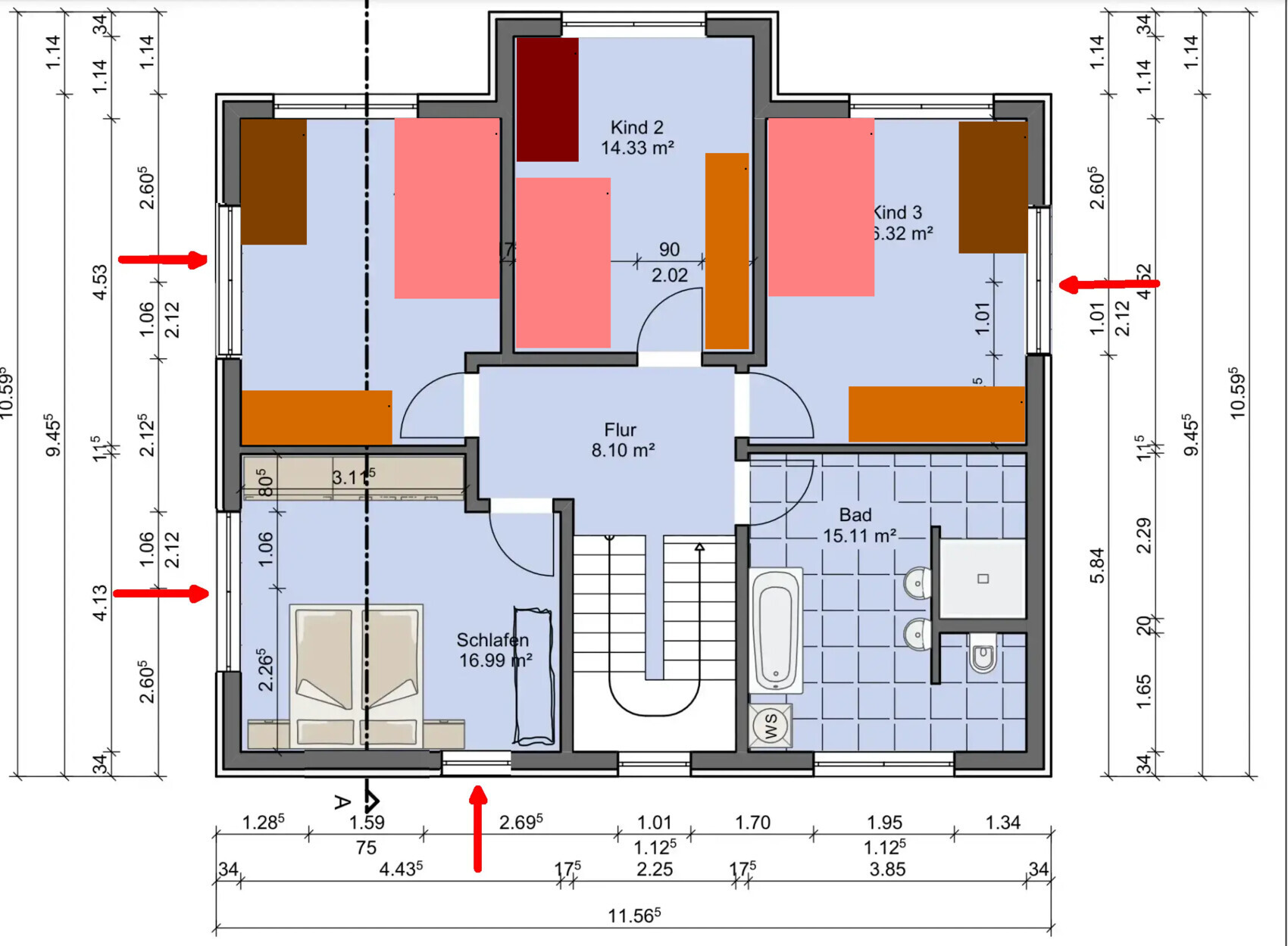

The door position in your floor plan drawing doesn’t match the layout from post 107. Have you changed it again?
Also, the desks in your drawing are slightly in front of the full-height windows—why are they placed away from the wall?
This is just a quick and rough sketch, not measured—only approximate furniture sizes. I usually try to plan children’s rooms with a 140 cm (55 inch) bed. That’s what most want once they reach their teenage years.
My conclusion: I find full-height windows on the upper floor, which are fixed glass at the bottom, somewhat impractical. From the outside, it often looks like the balcony has been forgotten.
kbt09 schrieb:
The door position in your layout drawing does not match the floor plan from post 107. Have you changed it again? Yes, I just noticed that too. I had started a post yesterday referring to the cabinets behind the doors, but with the current unfurnished floor plan, that’s no longer relevant.
What I want to say is: small changes can prevent some planned furnishings from working. If someone asks how you want to arrange things, you have to refer to the current plan.
kbt09 schrieb:
My conclusion: I find floor-to-ceiling windows on the upper floor, which are fixed at the bottom, somehow always pointless, and from the outside, it often looks like the balcony was forgotten. Yes, that fits some house styles and certain locations, and it depends on the room. Never in bedrooms.
I don’t understand the windows on the front facade at all—I would try repositioning them, including the bathroom window and those on the ground floor. But currently, I don’t have a clear overview of what would be feasible. Personally, I would spend more than an hour thinking about something like this: drawing, photographing, drawing, photographing… and eventually comparing the photos.
kbt09 schrieb:
The door position in your layout doesn’t match the floor plan from post 107. Have you changed it again?
Also, the desks in your drawing are a bit in front of the floor-to-ceiling windows—why not place them against the wall?
This is just a quick and rough sketch without exact measurements, roughly based on furniture sizes. I always try to plan children’s rooms with a 140cm (55 inches) bed, which is what most want once they reach their teenage years.
My conclusion: I find floor-to-ceiling windows on the upper floor, which are fixed at the bottom, somehow impractical, and from the outside it always looks a bit like the balcony was forgotten. It’s true that the door positions from post #107 don’t match those in #121. It was just an example to give you an idea of how I imagine furnishing the three children’s rooms. I don’t want to change the doors at this stage.
In my floor plan, there is more than 2m (6.5 feet) between the wall and the floor-to-ceiling window, so there should be enough space to place a desk without it standing in front of the window. By the way, I would also push the desk directly against the wall.
A 140cm (55 inches) bed fits in but will always be positioned in front of a window.
On Friday, I informed the general contractor that as an additional feature, we want a fall protection system mounted on the outside (French balcony). However, your post has made me reconsider whether it’s better to avoid floor-to-ceiling windows on the upper floor altogether. The windows likely wouldn’t be wider than about 1m (40 inches) anyway because of the desks in children's rooms 1 and 3. I also agree with YPG’s comment below that a floor-to-ceiling window in the bedroom is pointless. Also, the second children's room on the upper floor with its floor-to-ceiling window has more of an office feel.
Do I understand you correctly that for children’s rooms and bedrooms on the upper floor, you would only plan floor-to-ceiling windows if there is a balcony attached from the outside? Regardless of whether it’s a French balcony or not?
Yes, it fits some house styles and locations and depends on the room. Never for bedrooms. Thanks, that’s a good point. Having a floor-to-ceiling window in the bedroom isn’t ideal, even if it’s not right next to the bed.
@kbt09 @ypg
I need to process this first. Maybe I’ll remove the floor-to-ceiling windows entirely from the upper floor without making the windows any wider at the same time. Would that be a viable solution from your perspective?
Why does the ground floor have no east-facing window?
I wouldn’t want to do without one! Where will the carport be located?
Regarding the windows on the upper floor: the north window in the bedroom is quite unusual. Probably a continuous window strip was intended, and the architect drew a placeholder?!
If so, I would create a proper window strip of 3 meters (10 feet) and align it flush above the entrance door.
I would mirror the entrance door with a window and change the door swing. The WC door should open upwards. Then a sideboard can easily fit along the stair wall.
Upstairs: windows should follow a 1 meter / 2 meter (3 feet / 6 feet) grid.
I would allocate three linear meters (10 feet) for the children’s rooms. As arranged, it needs to be tested in practice. Personally, I find the south facade quite boring. You could experiment by swapping some windows within the 1/2 grid with the gable windows. But that’s just my opinion. Others may find such a facade calming.
