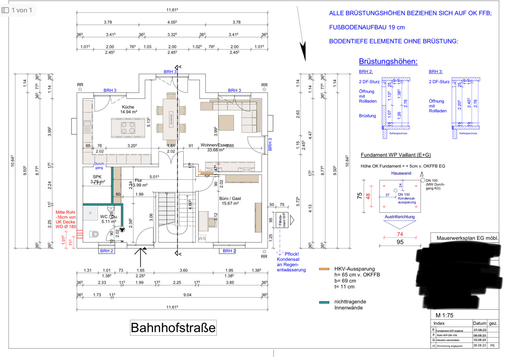

The kitchen front width there is 80cm (31.5 inches) as a passage. The actual clear opening through the wall will probably only be about 76cm (30 inches). The kitchen specialist should show the exact details. Personally, I don’t think the kitchen layout is ideal yet, but I’m also definitely not a fan of these hidden passages. What is the situation like when the door is open?
Gregor_K schrieb:
1. The kitchen planner told me that the optimal door width for the access from the kitchen to the pantry is 80cm (31.5 inches) with a distance of 65cm (25.6 inches) from the wall. This way, the kitchen cabinet fits perfectly with the door opening. I discussed with the general contractor that it might be better to use the next suitable rough opening size for a standard-compliant door. That would be 76cm (30 inches) and has the advantage that you can still install a standard door later on. Would you choose that as well or should I go with 80cm (31.5 inches)? I don’t see a standard interior door frame size being practical here; I would rather choose 88.5cm (34.8 inches) instead of 76cm (30 inches). By the way, I already wrote about this recently:
For beverages in PET bottles, an 80cm (31.5 inches) narrow pantry passage might be sufficient. But when dealing with crates of glass bottles, which require more force and less precise maneuvering, order robust edge protectors accordingly. .

I don’t see a standard-width interior door (frame) as practical here; better to choose 88.5cm (35 inches) instead of 76cm (30 inches). By the way, I mentioned this recently already.
I think you’re right, but I will discuss this again with the kitchen installer.

xMisterDx22 May 2023 22:20What exactly prompts someone to choose an 88.5 cm (35 inches) wide door for a pantry instead of 76 cm (30 inches)? Is it a commercial kitchen where half pigs, whole cattle, or numerous refrigerators need to be carried in and out daily?
Especially since every centimeter of door width in this tiny pantry takes away valuable space for shelf depth. Or are you planning to have the door open towards the kitchen?
I would rather consider a 60 cm (24 inches) door. It’s a pantry, not a front door. Storage space should take priority over convenience here...

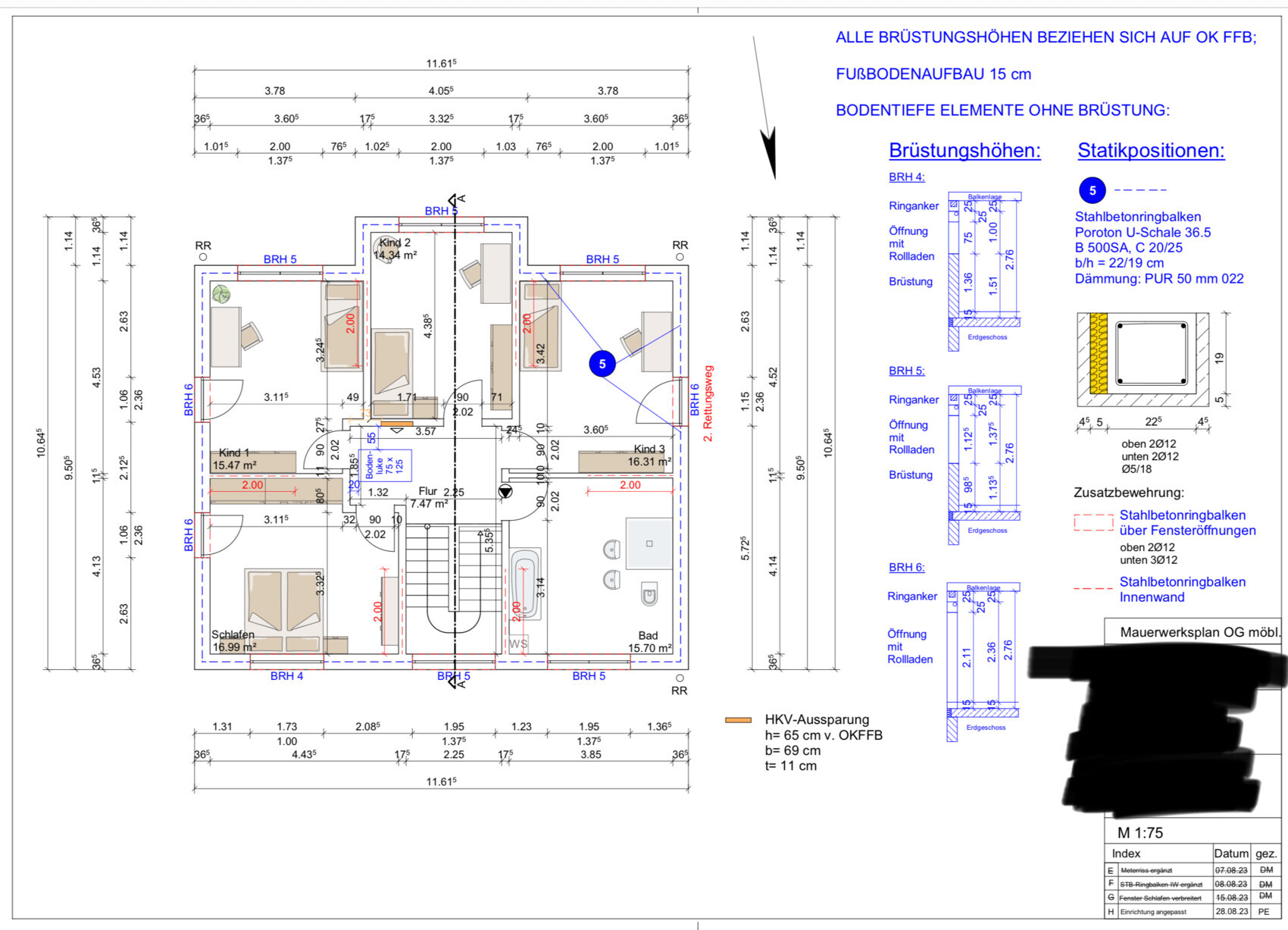

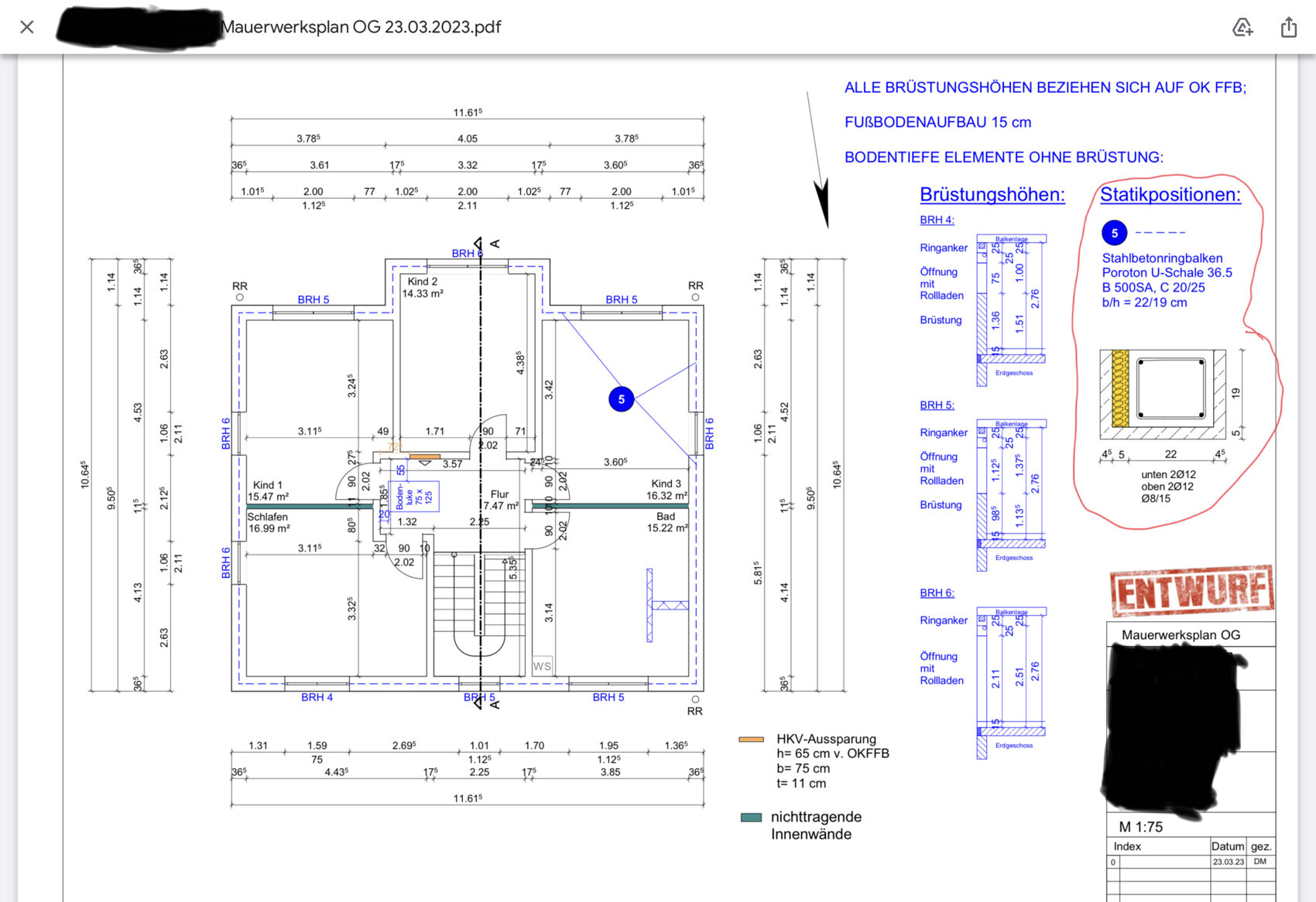

I am currently considering two things and would appreciate your feedback. I have attached the house plan again, this time without the basement. Don’t worry, the basement will remain!
1. Bedroom windows on the north side. There are three options: “Option_1,” “Option_2,” and the current design (see “Nord OST Ansicht.png”). Which would you choose? See the red circle.
2. The floor-to-ceiling window in the living room area, behind the sofa, is actually unnecessary. What do you think about replacing it with a standard window? It has also been noted that the open-plan space already has more than enough redundant exits. See the red circle in “Süd und West.png.”
