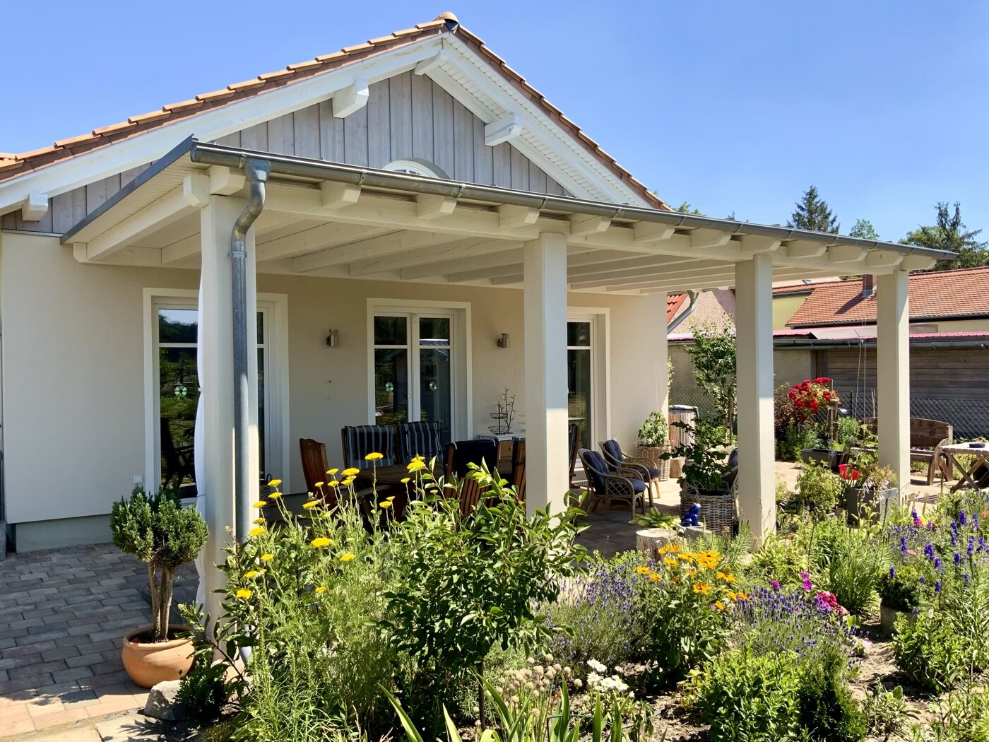

Our patio roof is even 4 meters deep (13 feet) and extends almost across the entire width of the house. There really isn’t a “light problem” inside the house, as natural light also comes in through the side windows, just like in your case. For aesthetic reasons, I wouldn’t extend it all the way to the edge of the house. In summer, such a roof helps maintain comfortable temperatures inside the house and on the patio.
Veranda eines Hauses mit überdachter Terrasse, Gartenmöbeln und bunten Blumen im Vorgarten.
19 Apr 2023 19:42
I really like your house, @Steffi33
However, I would still not recommend installing opaque canopies in front of windows or patio doors.
