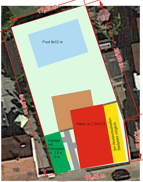

I have now roughly measured the dimensions with my CorelDRAW and placed a rectangular house. I find the [floor plan] from @saralina87 quite suitable.
Light brown ... possible terrace
Dark brown lines - fence to ensure the garden’s privacy
Overall, there could be windows all around, which I find especially important since the south side is not suitable for large windows. In general, a full-height upper floor rather than a knee wall of 180 cm (70.8 inches) is recommended here.
One question I still have: is the 30° roof pitch mandatory or just a preference?
EDIT: I just saw the post that the garage does not have to be on the property boundary but can be set back 5 m (16.4 ft)… What about a carport, and does your car really need a garage? Would a carport with an adjacent bike/garden shed be possible on the green area?
